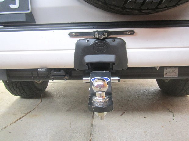

Sounds like they didn't torque up the bolts properly. Or there is some other issue they are keeping quiet about.Originally posted by Jeff.C View PostAndrew I have not heard anymore yet only that the new bar bolts were loose so I will post more once Toyo get back to the owner

Rang the Toyota Dealer that removed my " Caravanning neighbours" Towbar to check that there were no ongoing problems.
They said that this was the first time they have had the problem reoccur and that they believe that whoever did the original replacement did not torque the the tension correctly They did not tell me what they were doing but I think that they are replacing the replaced Bar.
I have decided to change my bar cost $500 compared to cost of van thousands. Are Toyota bars good or bad, I have seen broken ones, not just lose. I'm not waiting for the jury decision. To me 500 is a small price to pay for piece of mind. If you think that happens to other people, one day God forbid one day any of us could be the "other people"
Well after following this tread for last 6 months, had received the toyota letter - decided to have the whole toyota system ripped out and install a Hayman Reece (class 4) tomorrow for $495 fitted - peace of mind as well, bugger them with putting stickers on the OEM one (no affiliation with them below)Originally posted by KIMBOPRADO View Post
