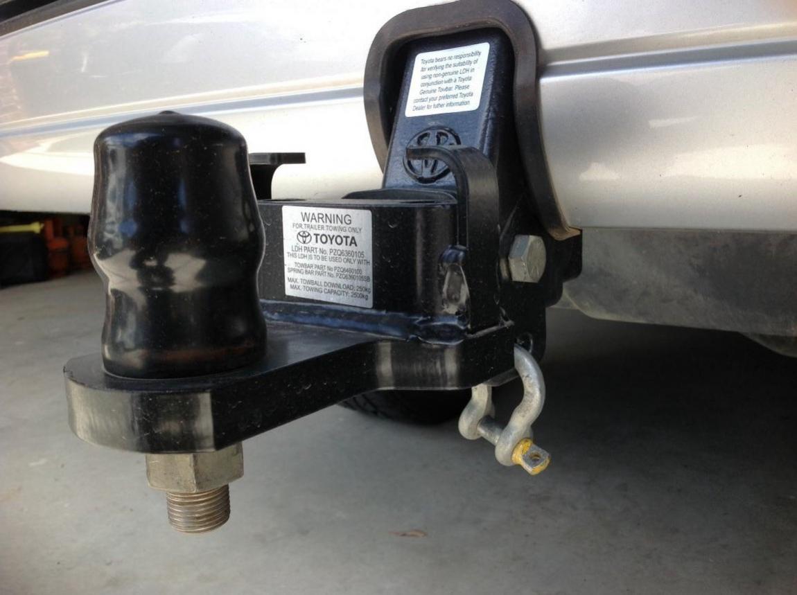

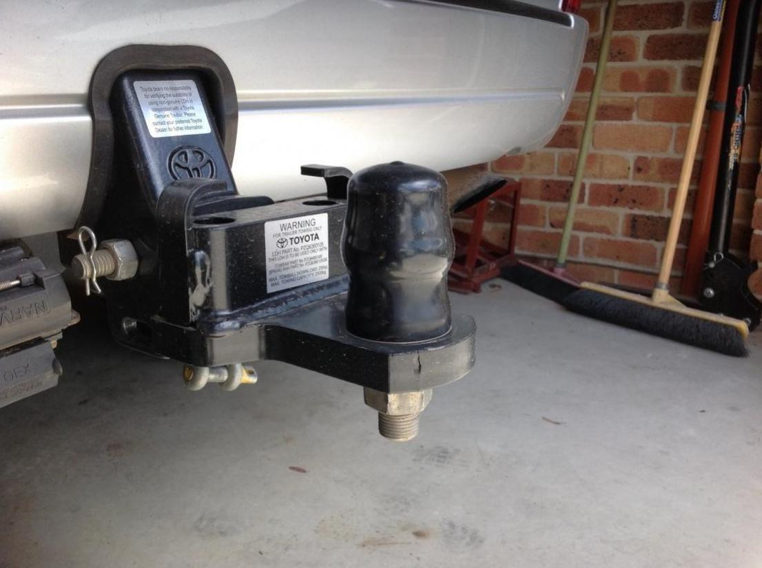

              Any luck with a photo FC?
              OK 2 photos of hitch head, the rest is in the front boot of the van
              will take photos of bars etc when near the van again, thanks amts for fixing the photos don't know how to rotate them with an IPad
              FC_Holden

              • Thanks FC - not at all what I was expecting it to look like!!
                Certainly no good for any of us with a lift - or a lifted van to match...
