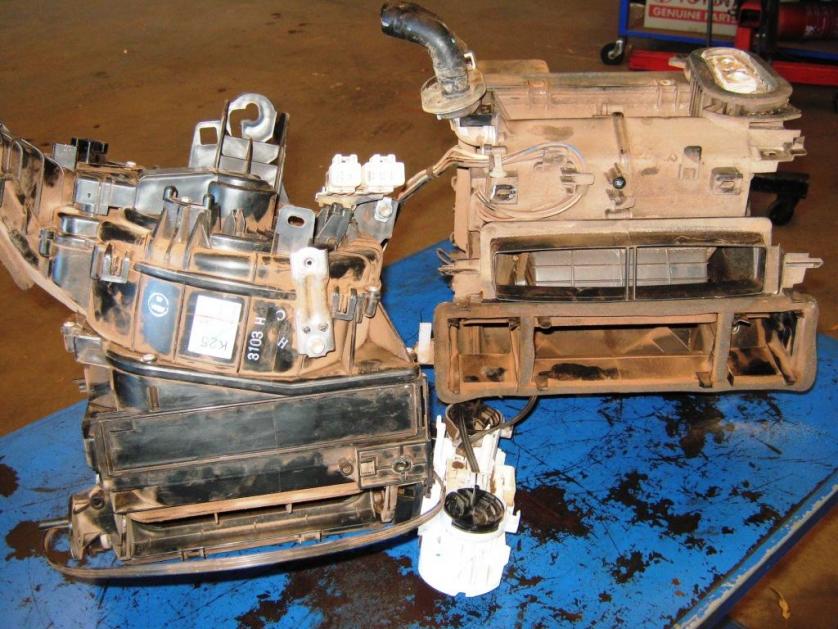

hi pusslux, have had a little bit to do with a/cs first thing u want to do is to make sure the evaporator is nice and clean if this is clean and free of dirt and mud the next thing to do is check the TX valve or the desiccant bag. With the TX being blocked it can lead to system to run backwards(in a round bout way) the bag ( if blocked or dirty) can lead to the same thing occurring. the bag is really easy to change u will have to get a "expert" to do it as well
hope this helps and good luck..
regards mick."wounds heal but scars last for ever"

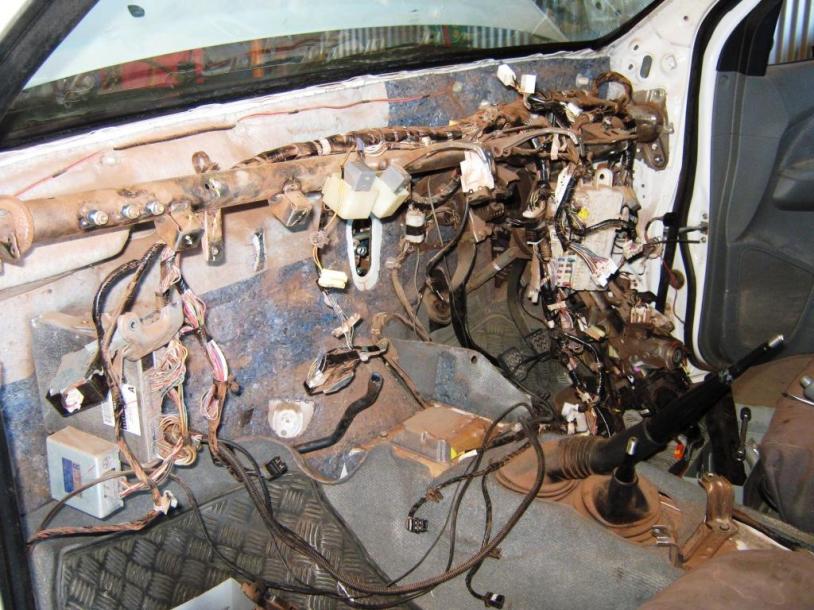

well the only way to clean the evaporator properly is to remove it from under the dash (passagerside) can b a big job as u have to remove the gas, pipes and the rest of the components that attach to it as well. I no that on the old hzj cruisers u can wash them out whilst in place. As Bear63 said check the heater side and make sure at the heater tap is not jammed opened"wounds heal but scars last for ever"
