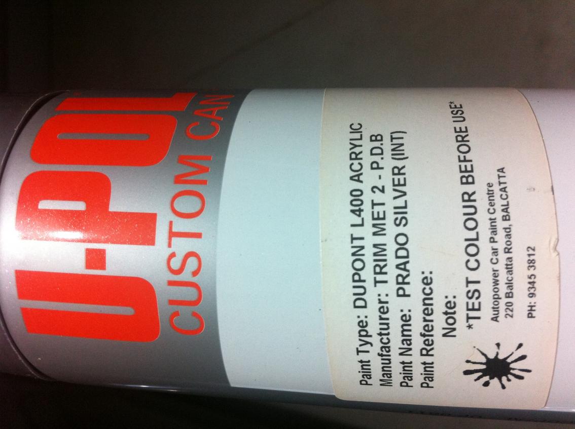

            Hi Fronty, I will have a look on the can I bought from a local auto paint shop here in WA (Balcatta) and report back when I get home. The guy came out to my 120 found the paint code in the passenger side door well (should be there for you too). He then looked it up and already had a couple of cans mixed up. Was as simple as popping off all of the trim, cleaning then I sprayed each one a couple of coats and looks just like new. The colour is almost identical to the original, very hard to pick the difference if at all. Good as new!
            Wardos.
                This is the paint I used, came out almost identical. You should be able to see the shop details as well on the bottom sticker if you wanted to contact them.
                Wardos.

                      ozwapet2 have a look at post 37, I have a pic of the can I used to respray my trim. It is as close to the original colour as you are going to get - I cannot tell the difference! Cost me around $25 - $30 from memory.
