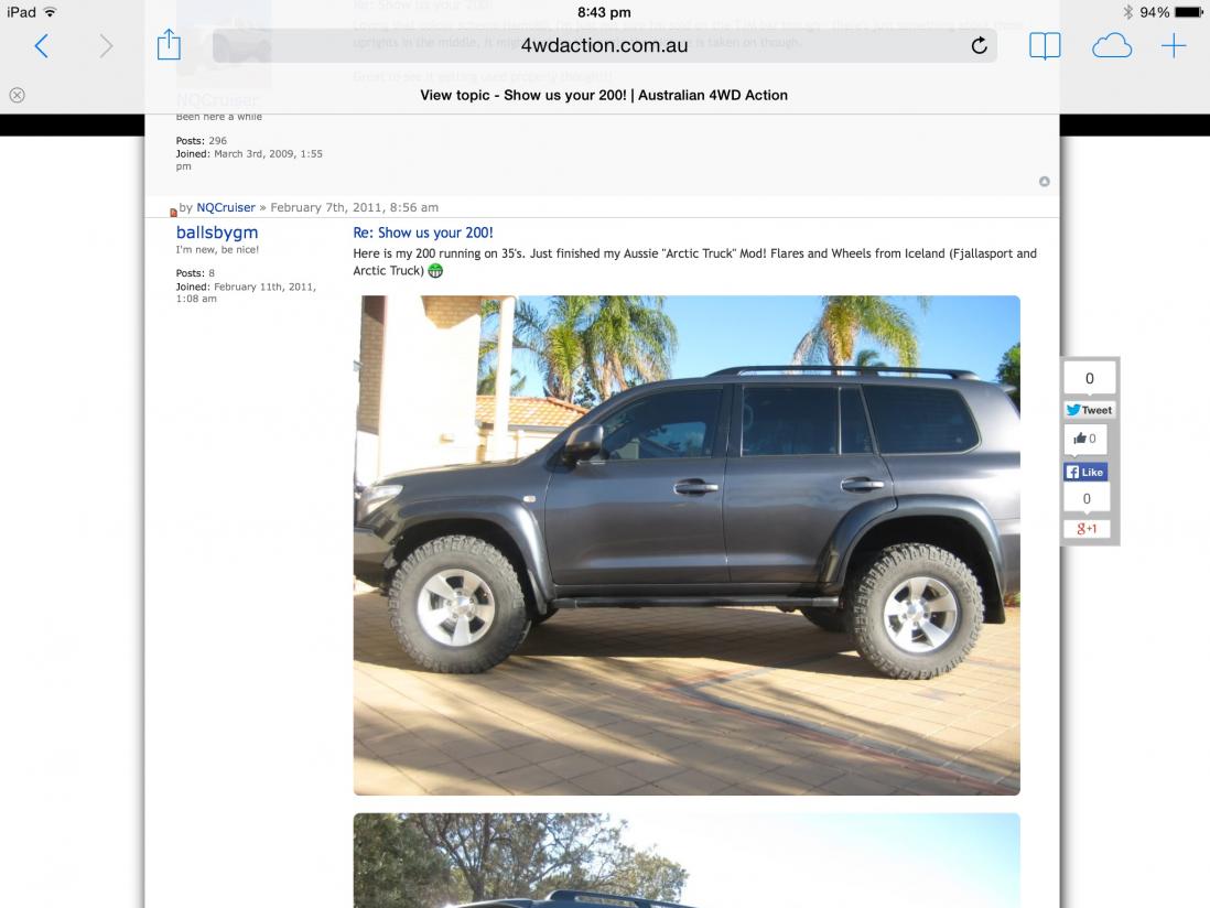

        There is a build on the Lcool forum, and a bit of info on the 4wd action forum.
        The conversion was sent here from Iceland, and the install all done here.
        Okay, did more research and the parts came from fjallasport in Iceland which will ship to Australia, and are located down the road from arctic truck! Seems arctic truck use the flares from fjallasport, and the wheels came from arctic truck but sent by fjallasport.
        Hats off to this guy for cutting up his 200

          I thought that would be the one you were talking about. A 35" conversion on a Prado is a lot more than just adding flares, they also relocate the font diff and drive shafts. Once again your talking mega dollars and its questionable as to whether it would pass engineering, assuming you could get all the parts.
