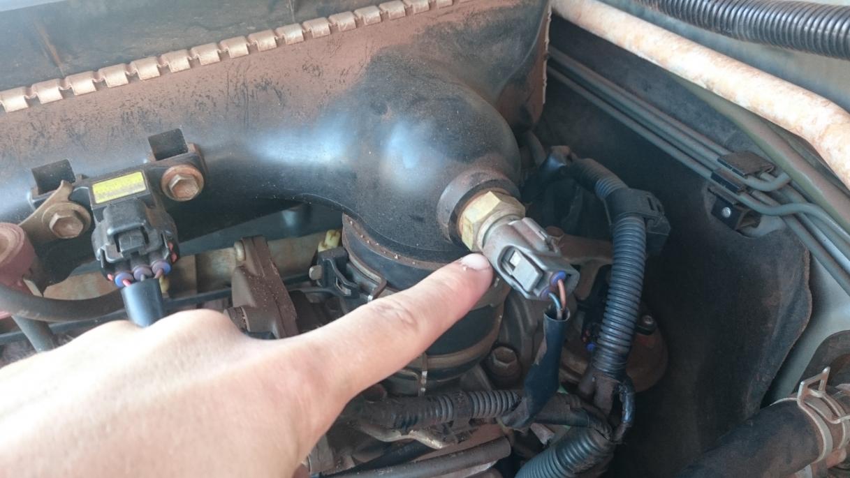

      Not intentionally running a finer filter just bought a standard air filter one from Auto One in south Hedland, just to be clear this is not the MAF sensor normally on the air intake box, this it the Air Intake Temperature sensor that goes into the side of the inter-cooler. Please see pic.

        If yours is similar to the later model 120, it is normal to get an oily dirty film
        in the intercooler, the oil is from the PVC and breather, the black dirty deposit
        is from gas from the EGR system mixing with the oil. This should not cause an
        issue as every other Prado similar to yours would have the same problem.
          I'm not intentionally using a finer filter I just bought a standard one from Auto One, it's only about 2 weeks old, I'm concerned that it was so dirty before I replaced it that maybe the build up in the hoses (on the engine side of the filter) is causing the rapid build up on the sensor - Just to be clear I'm talking about the Intake Air Temperature sensor. I'll post a pic below

              Ah ok, thank you very much LeighW. What else electronic sensor can gather build up over time? Also is it possible that there is something wrong with the alternator and it is overcharging?
