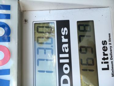

                If the trip computer says range is 0km, the low fuel light should have come on well before then.
                Filled up 177L today after 1174km = 15.1L/100km
                Fuel warning light came on at 1085km.
                DTE hit 0km at 1139km.
                Won't be attempting this feat again, that's for sure.
