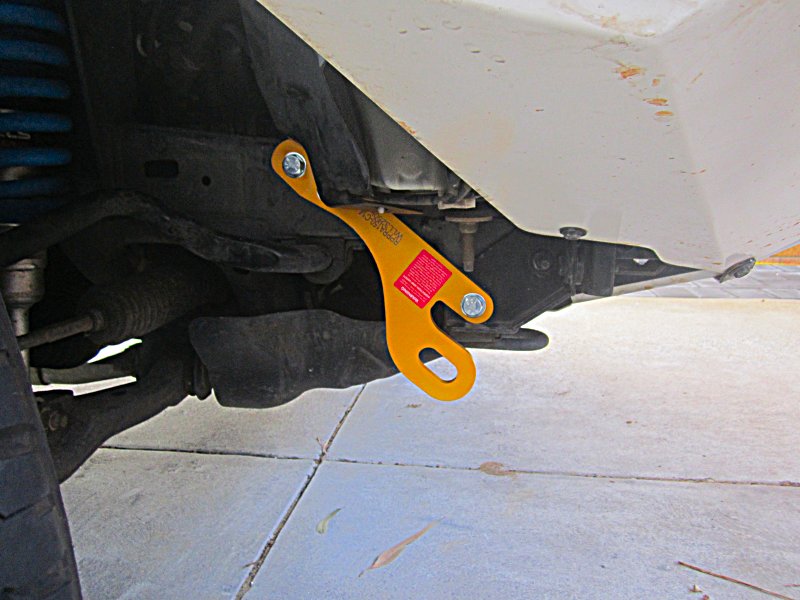

          Thanks everyone, got the bar and didn't have to much trouble fitting it. Now looking for front recovery points that will fit without having to mod the car or bar. Any help??
            I fitted a set of 150 series recovery points.... Only had to drill one hole larger to suit and easy to fit without removing or modifying anything
            David (AKA Grumps)
              Did you have to move the radiator to fit the 150 brackets
                No need to remove or move the radiator. Nuts fit inside the chassis and come supplied with wire tack welded to enable feeding them down through a hole.
