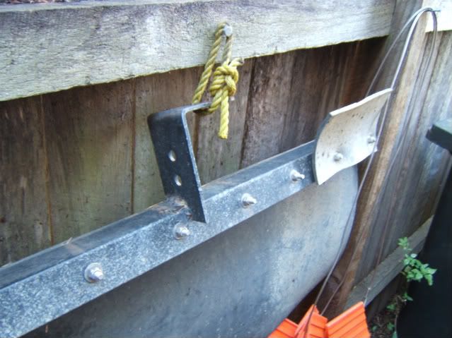

I have made a large mud flap to deal with this problem when I tow the camper into dirty or mud circumstances. It serves the purpose that you have in mind but I wouldn't leave it on permanently.
It was made with a gal 50 x50mm fence post from Bunnings, attached to the car via the bolts at the end of the chassis. The rubber was from Clark.Dirttracker, (Martin)

Do you have any further close up pics of your large mud flap, specifically how you have atached the rubber to the 50mm post and how its attached? Also what thickness of rubber did you use?
Do you find it causes any other problems having it on?

Here some close up pics of the rear mudflat.
The bar across is 50 x50 mm gal fence post. The brackets are L shaped gal brackets bent to suit and welded on. The rubber is attached and a alu strip as backing, bolted right trough with SS bolts. An upper rubber section is attached that extends towards the wheel arch to stop the mud and stones that fly from the wheel arch .
I have to lie under the car to attach it. One bracket goes under the original tiedown loop, the other is above the exhaust pipe, hence the shape of the bracket.
It has been commented that longer mud flat would work. It is true that it stems from the 2" lift exposing more of the tyre, but I haven't anyone who has done an extension. I would be interested to see how it could be done. The Hilux have nice long flaps.Dirttracker, (Martin)

It isn't conveyor belt rubber but it does have webbing inside to strengthen it. It comes in a roll at the desired width, once determined. Conveyor belt would be the bees knees.
One word about putting it close to the ground, if it touches at any time, it will stand up the stones and cause problems for your trailer tyres, or flick them up towards your camper. Mud just needs a wash. Stones take your paint off!!
I am also cutting mine in two places to allow the air to pass through and I am putting a strip of aluminum along the bottom to stop chipping.Dirttracker, (Martin)
