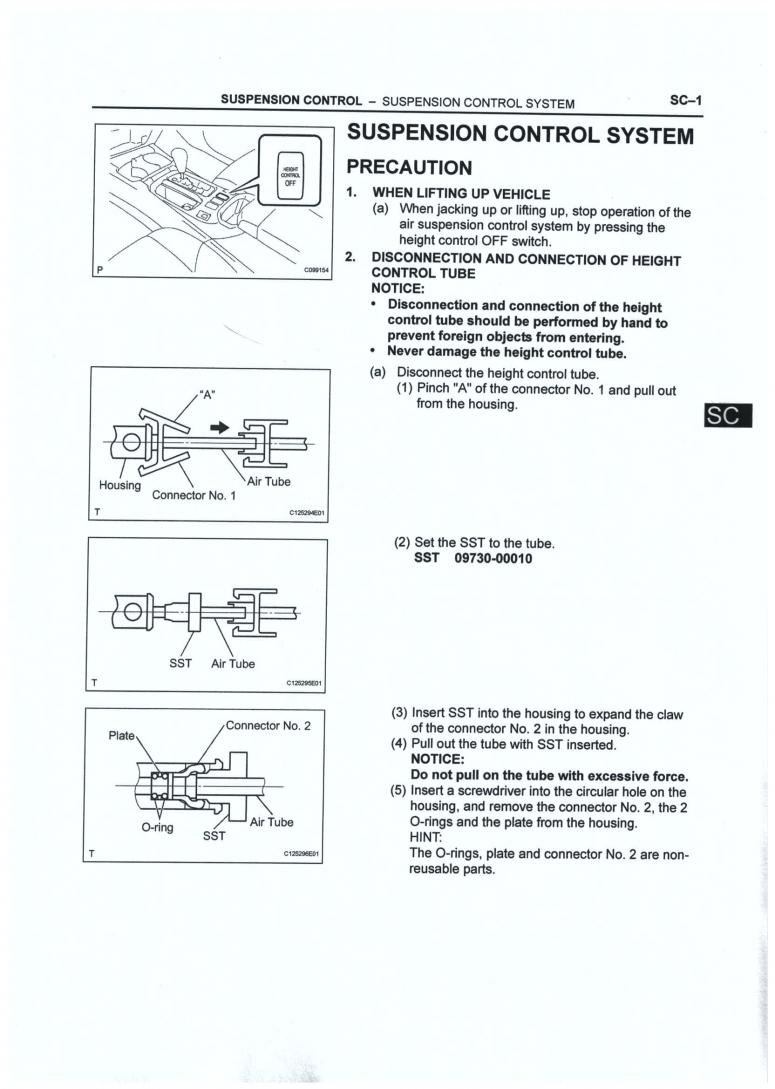

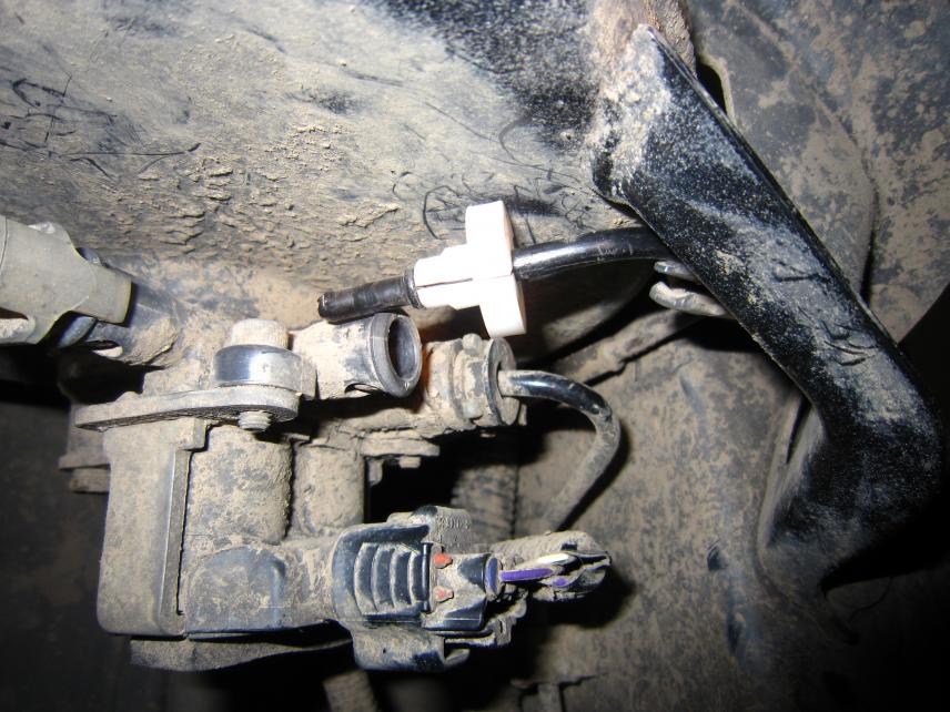

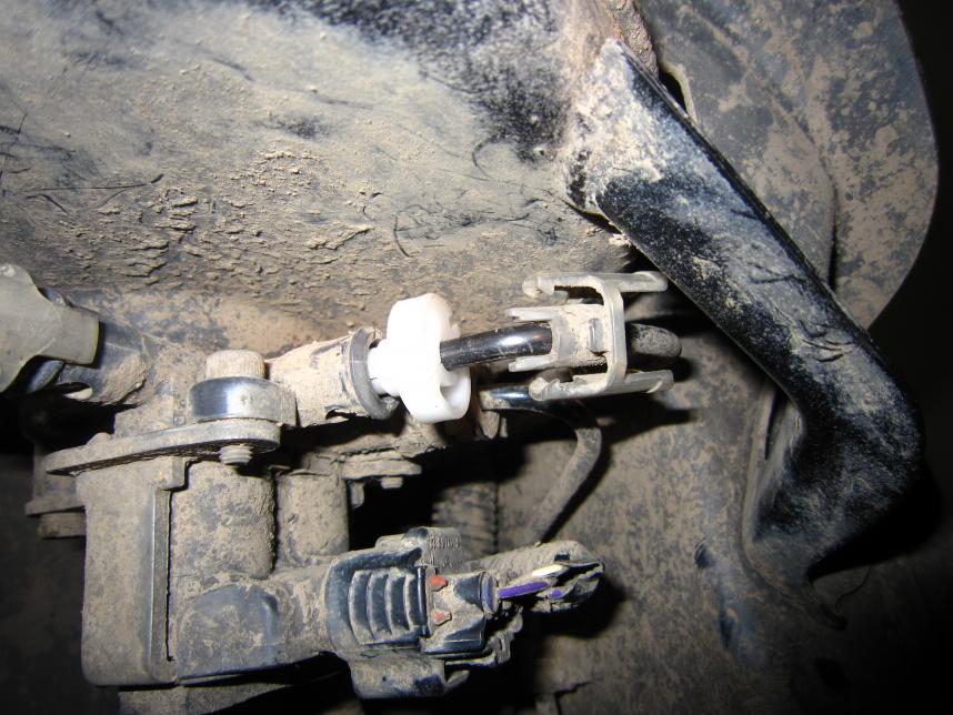

                  • The SST inserts into any of the air line connector housings to expand the claw that holds the air line in place as per the instructions below (expand the pic twice to read easier):

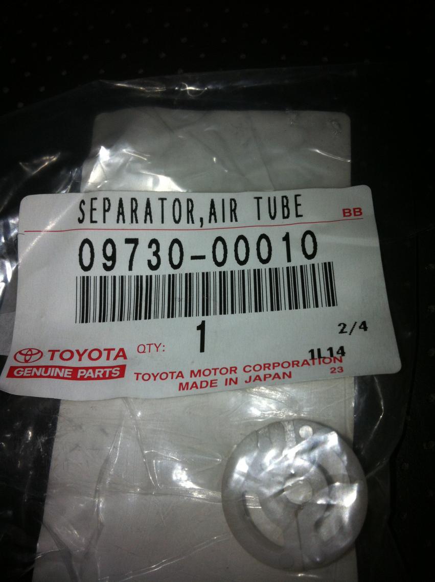

                      • If anyone needs the SST, I can get it for $30. Might save you guys running around. Might be able to negotiate a cheaper price for a bulk order from Toyota.
                          Excellent, Ill have one.
                          Ta
                          Marc
                          • Will do Marc.
                            Looks like I can't get it any cheaper. Also there's none in the country but 22 left in Japan. So if anyone needs the tool, let me know ASAP so I can grab the lot if there's enough interest.
                            • Like Peter I keep mine in the Glovebox just in case... $30 bucks for a little piece of plastic. But it's a necessary tool if you need to tend to these air lines....
