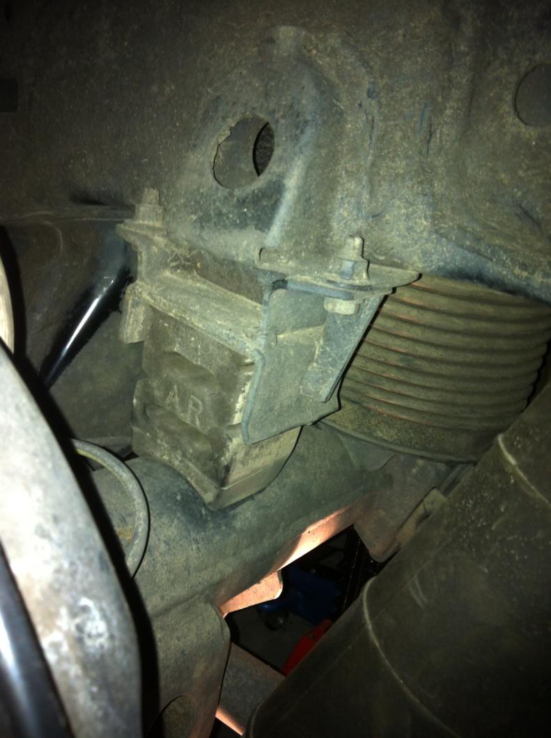

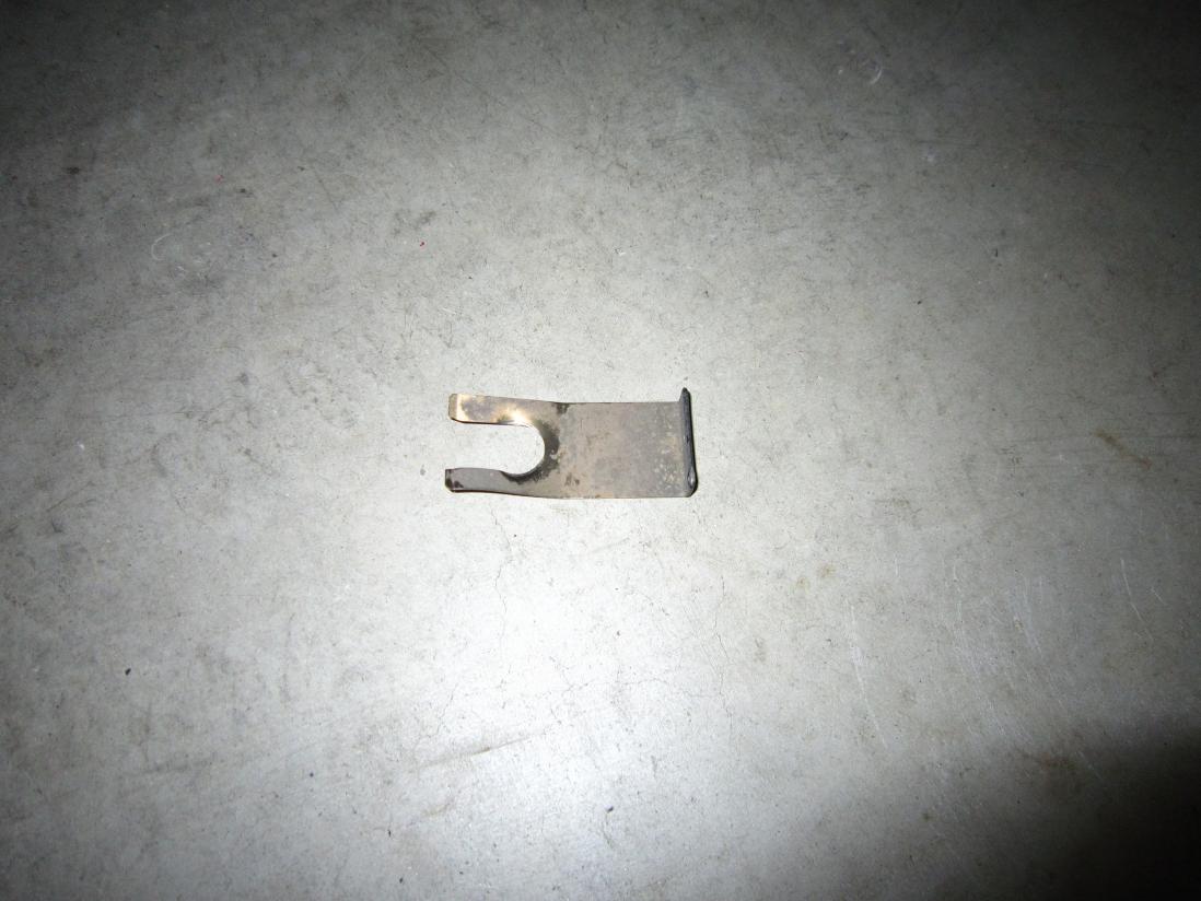

    • I can't get the measurements, the top clip on the airbag is missing and the whole airbag assembly is loose when deflated.
      • Uh-oh......
        • Yep, back to Toyota to get one of these:
          To hold the top of the airbag like this:
          • Originally posted by Peterpilot View Post
            It was a good thing you noticed it then Peter!. It's such a bitch of a place to get to as it is....

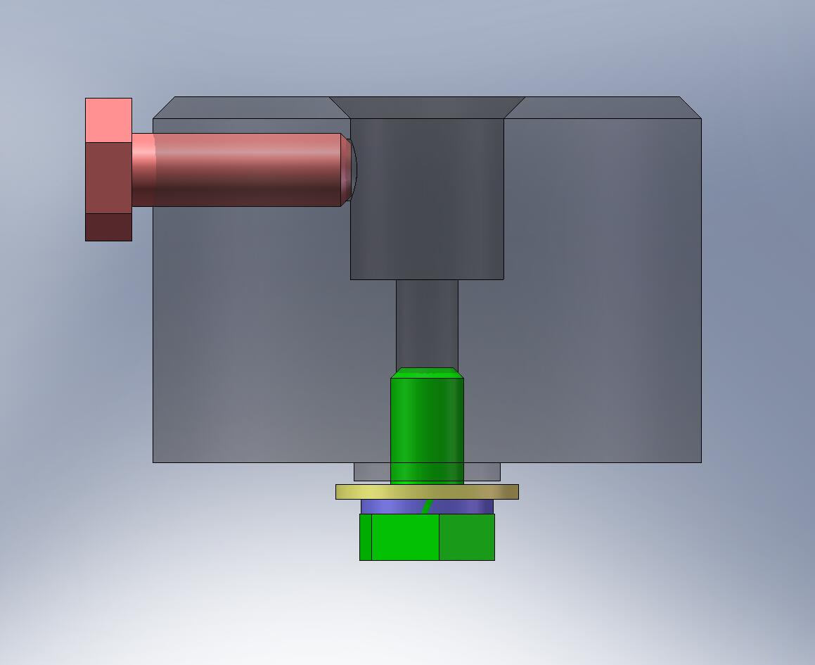

              In the meantime, here is a sketch of the spacer to keep you guys entertained.

              • Nice work as always Andrew....
                • That's a great drawing Amts, love it.
                  • Cheers Craig & Kev.
                    • Nice one Andrew
                      • Nice work Amts...like where this design is going

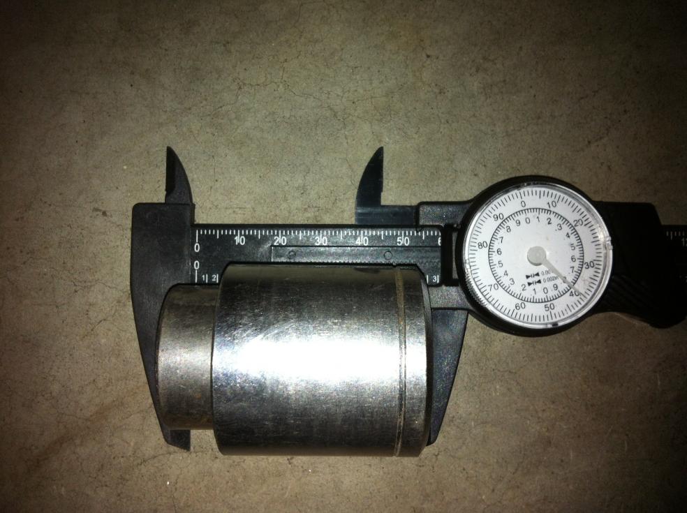

                        • In order to lift my deflated airbag back into position I wedged a couple of 1/2" sockets under it. The total length of these sockets was 54mm and with the airbag pin inside the socket, the airbag wasn't high enough to replace the top retaining plate. I then put the pin at the bottom of the airbag on top of the socket rather than inside it and the airbag was now in position and still with some freeplay.
                          Based on the fact that with the vehicle on bumpstop with a 54mm object plus the length of the pin under the airbag, there was still some freeplay at the top of the airbag, a 50mm spacer with the airbag pin inside should not be an issue.
                            Excellent job, thanks for clarifying that
                            • Nice work Peter.
                              • And drawings just submitted. Spacers coming soon. Watch this space.
