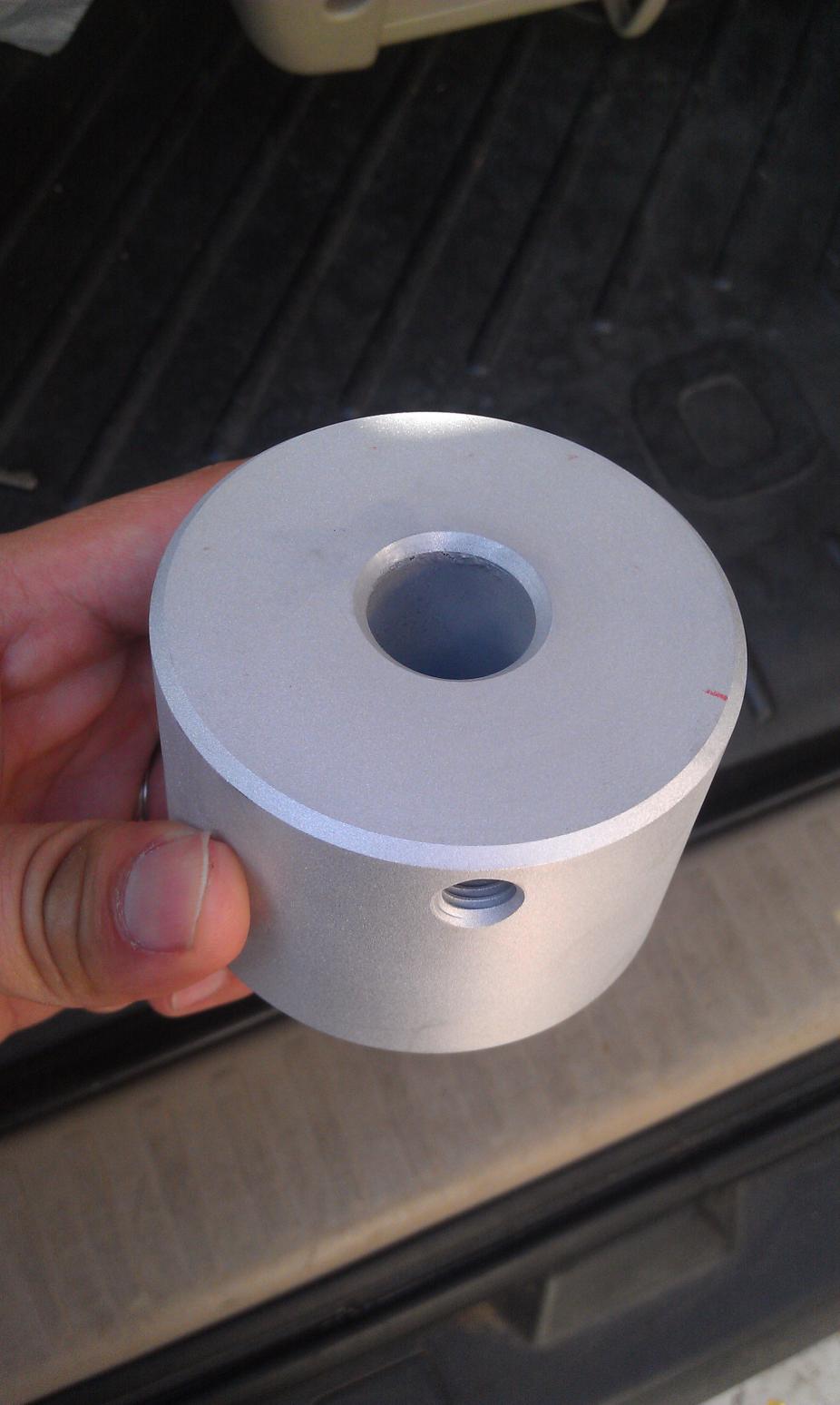

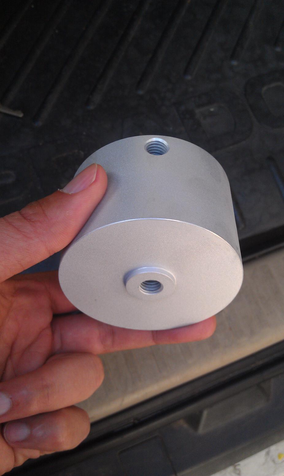

    Picked these babies up today.
ID:	640724Click image for larger version
    Need to trial fit them and work out the bolt lengths. Then off to anodising.
    I'm also trying my hand at making the SST to see if they can be done cheaper. Obviously I'm not making them myself as for those who already have the SST, it looks kinda complex where it snaps together and the 2 halves pivot to open up and go around the tube, etc.

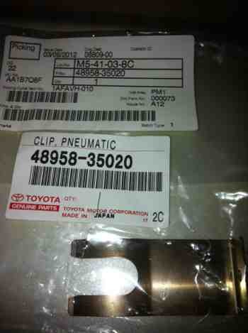

    Got the top airbag retaining clip from Toyota today.
    Thankfully, it was reasonably easy to install this time around
