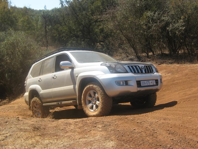

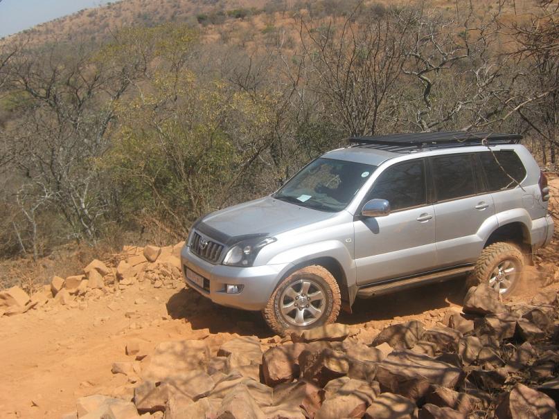

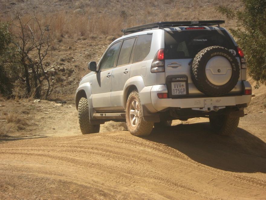

Hi Guys,
I need some advice please. I intend upgrading to an EFS suspension from my standard one but I'm confused as to which one I should go for.
This is my current set up:
1. Roof rack which will be heavily loaded at least 6-8 times a year (incl Hi-Lift jack, spade)
2. Fully loaded cargo area with fridge and all other stuff
3. 2 adults and 2 kids.
4. rock sliders, and replacement (Lynx 4x4) rear steel bumper.
5. 4mm bash plates soon to be fitted
I use the vehicle for trips and maybe once or twice a week (unloaded) as well.I also do trails once a month.
I intend installing an ARB sahara bumper in a couple of months so I need to consider that as well.
Should I go for the Elite, Enforcer or ExtremePrado 120 V6
