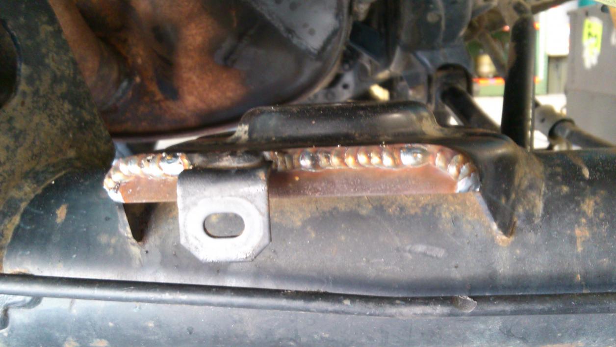

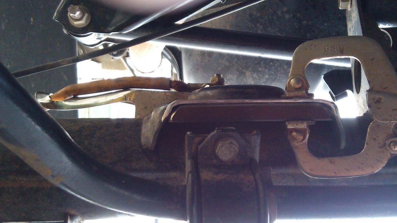

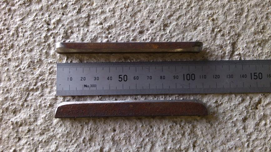

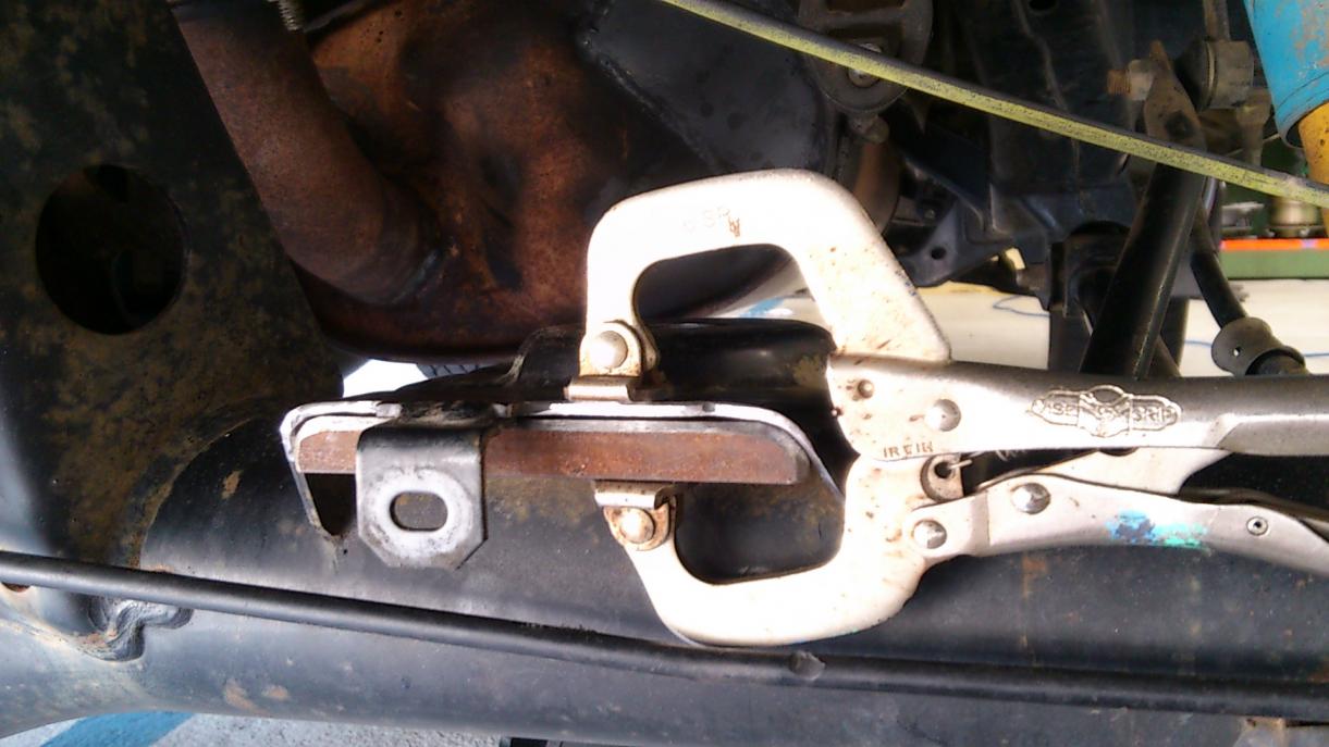

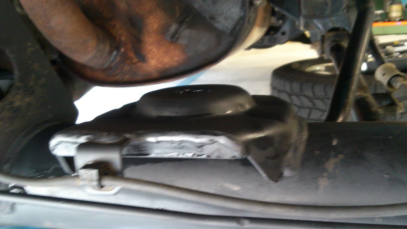

                        • #87
                          Hi again, I finally got around to straightening and reinforcing my drivers side mount. It was only distorted by 1-2mm but I have been having all sorts of problems with my drivers side blowing out. I have strengthened the front and back of the mount with some 10mm x 5mm steel. It now seems much stronger and I don't think it will flex under load.
