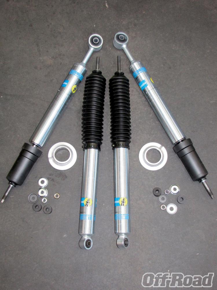

                    I have dug up a pic of the Crimped over end 5100 Series , sorry its not the biggest pic, but you can see the machine crimps in the end.
                    These are the one's that are coming out of the U.S that are Not serviceable.Click image for larger version
Name:	Bilstein-5100 Crimp over.jpg

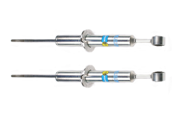

                    These 2nd one's have the removeable screw in end cap.
                    These one's are the 5100's that are coming out of the U.S that Are serviceableClick image for larger version
Name:	Bilstein 5100 Serviceable.jpg
                    I will do a separate post on these.
