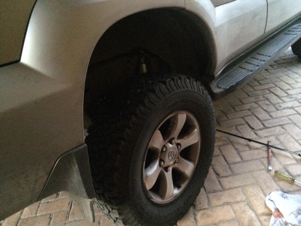

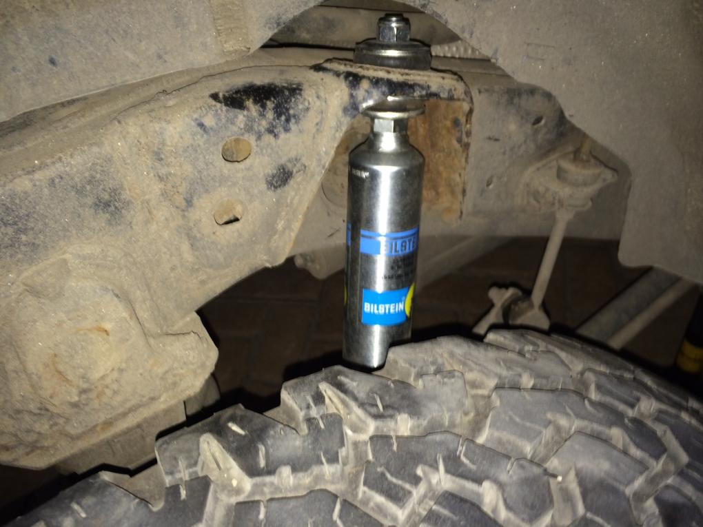

ID:	652364Click image for larger version
ID:	652365had the OME sport shocks and struts which i took after one month due to the harsh ride
                              mounted the bilstein 5100....amazing ride, road & off road, great down travel
                              This trial and error cost me some money...
                              Rear lift 5 cm, height of 82cm & 92cm fully extended 10 cm down travel
                              Will send some pics later
