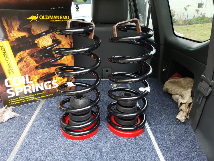

            I also replaced my Grande air bags with coils and new shocks in April this year (2016, it is at roughly the height it was on the high setting, maybe a little below. Best thing I have done. Only downside is the ride is certainly firmer (heavy duty coils), on the up side it is less floaty. (front was all ready lifted last year).
            Cost was $450 I think for the conversion (welding the brackets on) then the cost of the gear (icon shocks with Dobinsons springs)
            Darren from Autocraft Geelong - he used to be on this forum a lot, and had done loads of these conversions, so I was really happy to track him down - hard to get responses via email but persistence paid off.
            They also can do a bigger all round lift including dropping the diffs, but i already had the front done.
            Good luck!

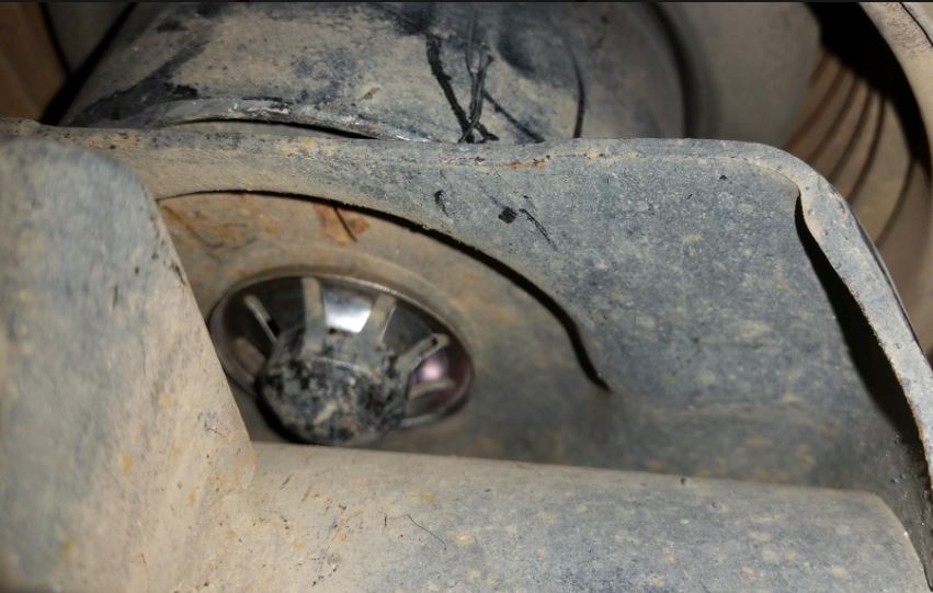

              Just done mine the other week as i Lost an Airbag
              I bent up small bit of flat bar to install as a retainer at the bottom and drilled a 10mm hole through the centre and bolted it with a washer and nylok where the old bottom airbag locating hole is.
              Ill try to attach a pics
              For every part broken comes the great opportunity to upgrade, enhance and improve. Just dont tell the other half how much its going to cost.
                I know the Springs are not going to come out but just some extra insurance. Im a bit scarred after the airbags decided to leave me on the bumpstops

                  I found these retaining washers (push washer) from China. Work a treat and fit easy as,Click image for larger version

                      @Caffome Fiend - as above I replace my 2004 Grande Airbags with springs. Best thing I ever did as I now don't have to worry about them. What is next to go wrong? Pump breaking etc etc. I did look into airbag man and my conclusion was stick to Toyota in the end as some people reported issues when over flexed. The coils however have been fantastic.
                      What did I lose?
                      Obviously the adjustment - but really it was just a gimmick
                      Self levelling - This is probably the biggest loss if you tow a trailer I think
                      Comfort - yes it was certainly a bit stiffer, especially to start with (I don't notice now)
                      Cornering - nope, it was better with coils I felt, not that was racing it or anything
                      Ability to Lift - nope it has more options if coils I think
                      articulation - nope, seems better - but that is probably the lift.
                      the height of my lift is what it was like on high. you won't be able to go much higher anyway due to hubs.
                      I found I often ended up on the bump stops and had to reset my suspension. I don't think it was leaking though.
                      With coils it is like a normal car, you don't even think about the suspension anymore.
                      Good luck with your research.
