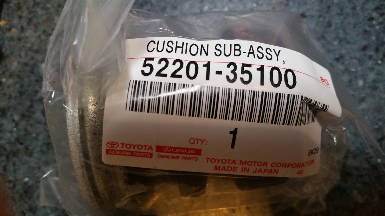

            Check your left front body mount. The centre part of the rubber gets chewed out and the steel inner sleeve knocks on the body mount bracket.
                  Voice of experience here, I was chasing the very knock the op has described for weeks. Drop the nuts off the front body mounts and remove the lower cushion, the inner circumference of the upper cushion wears away and the inner steel spacer catches on the mount bracket.
