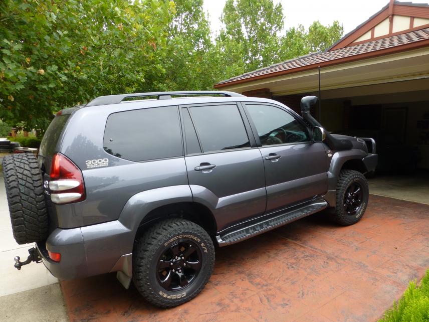

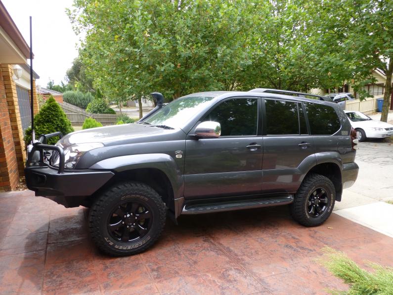

            Hi t4orce, should have kept the 17'' alloys & painted em black like i did, looks great & drives great

              You are a Sik pup Stevo, looks great! but I never thought I could have talked you into doing that to your wheels :-)
              Did you remove the tyres? What sort of paint? Nice.

                        Hi ####, nah did'nt remove tyres, but lots of prep,
                        & t4orce, still have to look after them or
                        They soon look crap

                            They say Black IS The new Chrome, anyways i reckon black rims improves the looks, & t4orce your truck looks GREAT!
