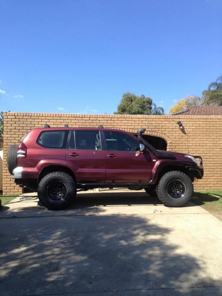

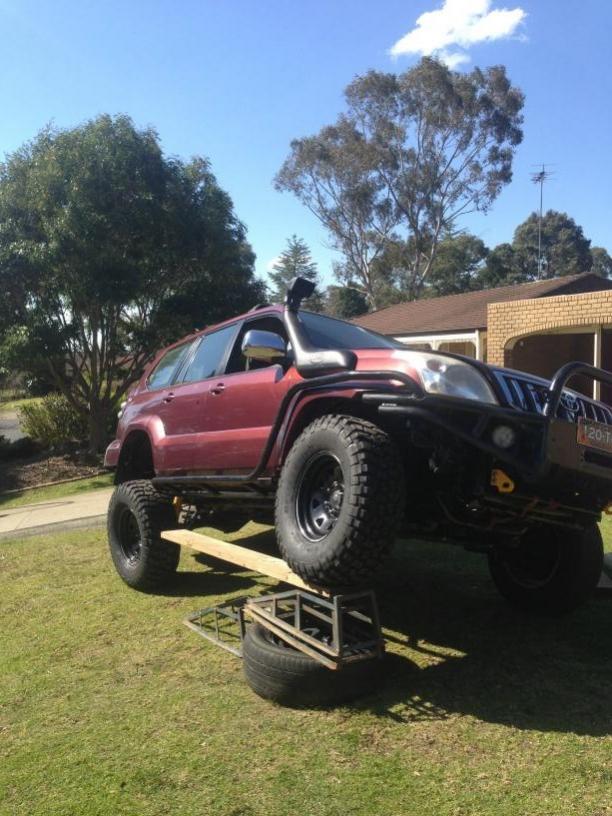

    Finally got the 35"s on , -13 offset , 2" lift , soon to be body lifted 2" , and rear lifted 4" with flexy coils using 6" 80 series shockies. Got pink slip so the lift had to come out for a little while.

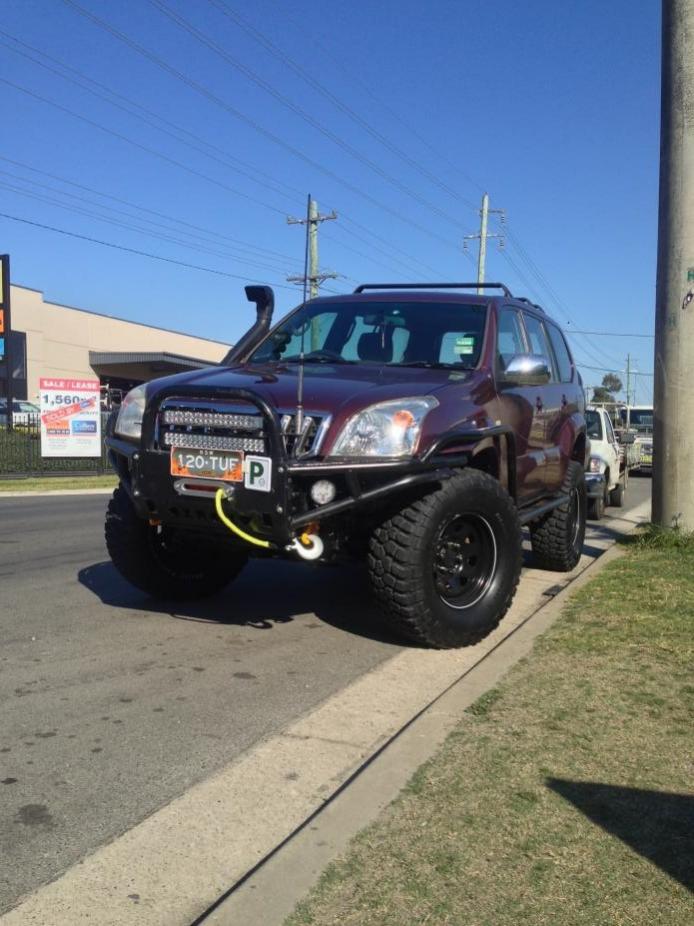

        amts
        Ninja Poster.
        2004 Manual Turbo diesel 1KZ-TE , 5" lift , 37x12.5 BF Goodrich KM2
          Ill do a wrote up when it's done. All I need to do in the rear is extend bump stops 2" , and since I'm running a 6" 80 series shock ill basically have the same amount of flex as a 4" lift, except I'm on 35"s couldn't be happier. Next set of tyres will be 37" with a 2" body lift. Very doable from what I can see now. No need to body lift for the 35"s

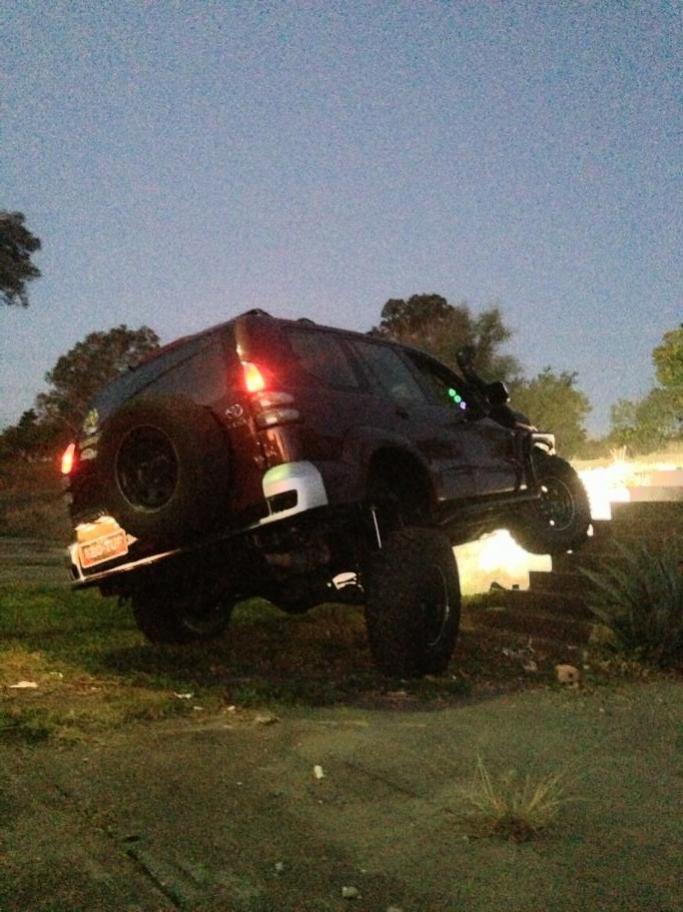

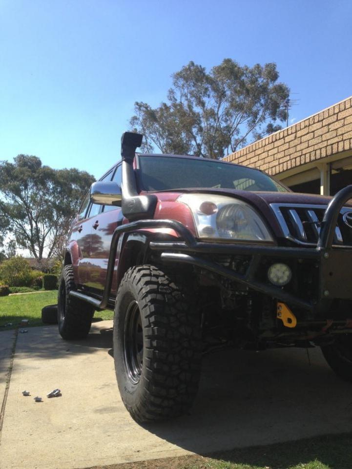

                        final flex test on 35" and this is how she looks

                          That flex is insane for a 120!!
