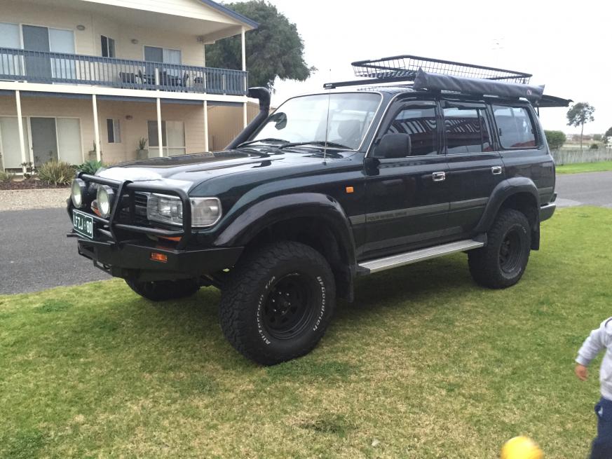

    i had a set on my old 80 series and did around 30k on them and they still looked new......not brand new but not even a 1/4 worn....had no hesitation on getting them on my 120 prado...so second set.....no questions

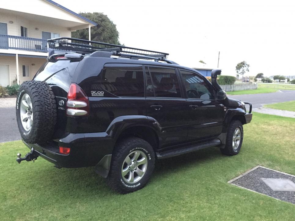

    Matt the 70 profile is 28mm bigger in diameter thus increasing ground clearance by a nominal 14mm. A 150 but I went from 275/65 to 265/70 and the difference in fuel usage is minimal.
    Can I ask why you went from 275/65 to 265/70 and are you happy ?.

    replied
    N
    Originally posted by myminirocks View Post
    Ahhhh.... Ok, I think I get this now..... Seriously, I don't consider myself a dumb guy (most dumb people probably don't either) but the tyre size thing has had me confused for a while.
    So as I understand it now, the 70 is 5% of 265 bigger then then the 65, or 13.25mm, but being a circle, would that not be divided in half because it is only one side of the tyre between the rim and the ground? Obviously you come to 28mm in total and divided by 2 to get 14mm but I'm struggling to understand why it was 28mm divided by 2 rather then 14mm divided by 2?
    Also I edited my last post.... Meant to say 5% more, not 5mm more. ��
    Ok I have no idea what you just said BUT....... In reference to your previous post,
    1 I think the speedo is more correct going by the gps... But no change you will notice if you don't have one
    2 I have no rub at full lock or with a bit of suspension flex ( driving on the beach, undulations.
    3 none that I noticed.. Maybe 1 lt per hundred if that...
    4 definitely won't fit the cover on and will need a spacer.....
    Definitely does give a touch more lift... I'm not worried about extra stress on drive train as they are Toyotas not pajeros so they are made for a bit of hard work so a little extra weight won't hurt as long as you don't drive it like you stole it...
    If anything I was worried about is the extra weight on the rear door hinge...
    I do know BFG make 275/65 size as well as the 265/70. Cheers Nigel

    Time for some new shoes. I have been very happy with the KM2's but time to replace.
    Quick questions for people running the 265/70R17's KO2's on a 120 Series
    1. Any Speedo change?
    2. Rub? (I have 2" lift) with sovereign Bar.
    3. Fuel consumption change?
    4. Can you confirm that it will not fit on the back door without a spacer and will not fit under the hard wheel cover.
    And just a general question about running 70's, does it place any further stress on the drive train that should be considered? My mechanic has advised against it because of the extra stress on the auto tranny/diffs etc.
    Oh and also my reasoning behind going for 70's is to get just a little bit more lift (to match the level of the camper). Am I correct in thinking though that 70's only add 5% more lift?
