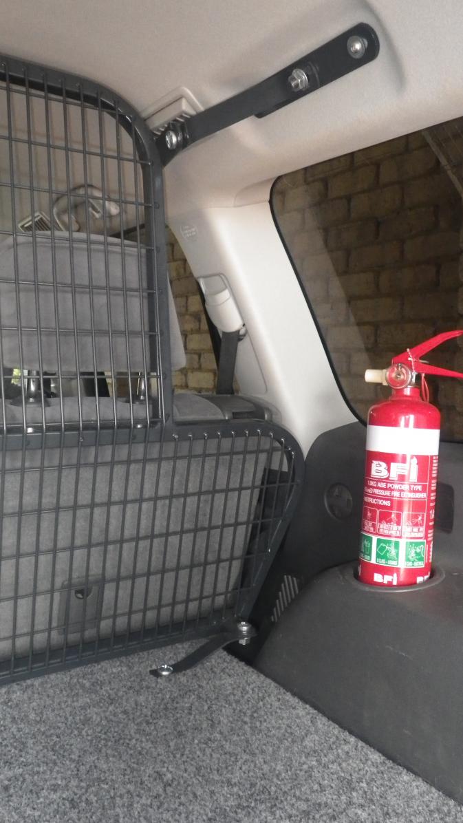

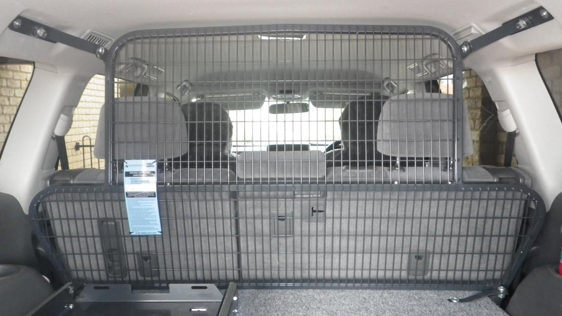

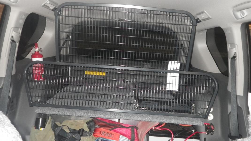

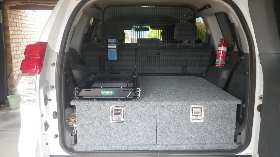

I went with Autosafe 'cause they will custom make the height of your barrier to suit. As I got an ORS DIY drawer kit which have many different heights, lenghts and widths; a standard cargo barrier or half height barrier would not fit. Just measure from top of drawers to roof height and its made for you for the same price as a standard full height barrier. $517 without fitting. Easy to install yourself as you just have to take out the grab handles in the roof and use the holes there and then drill holes in the drawer top and bolt in the bottom tabs (which are nice and small).

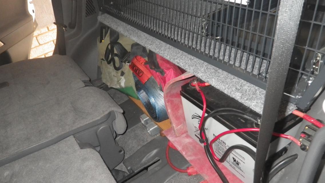

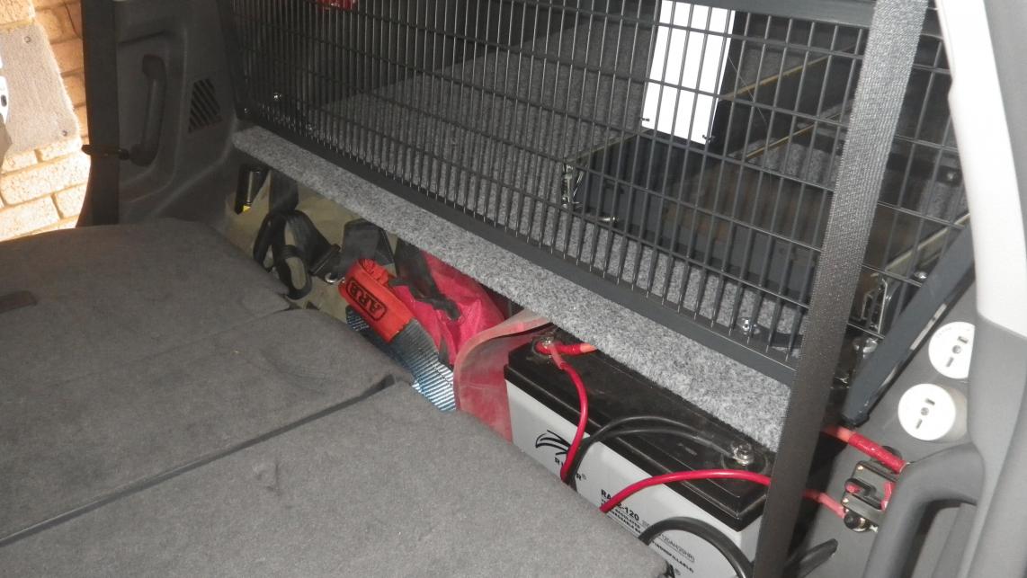

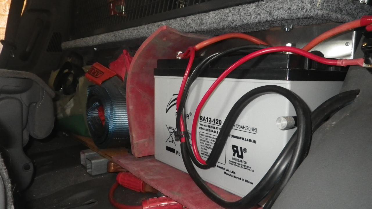

these last few show underneith the drawer top behind the seats where the drawer carcas ends and I have some storage room for the deep cycle battery and spare stuff
