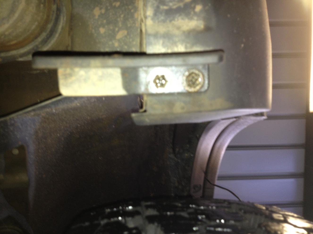

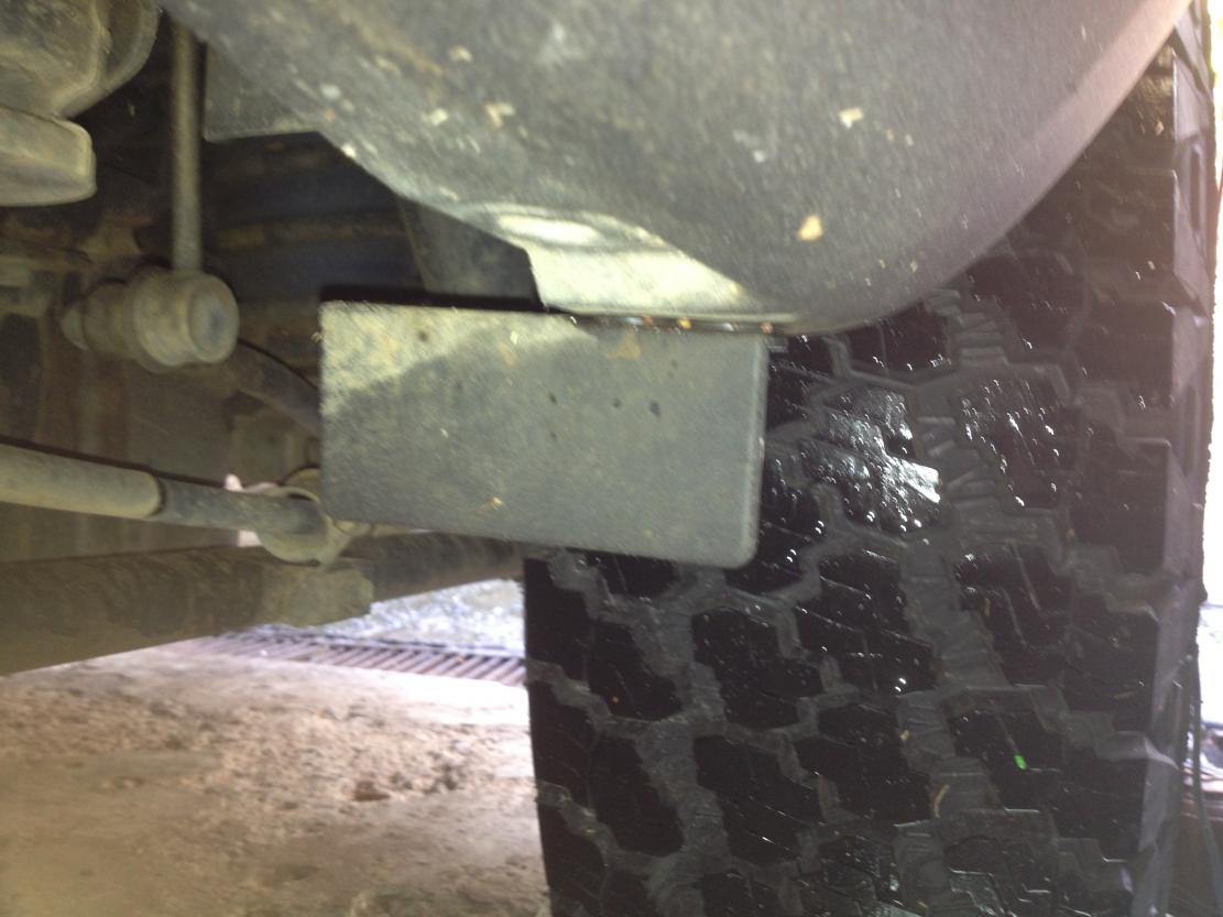

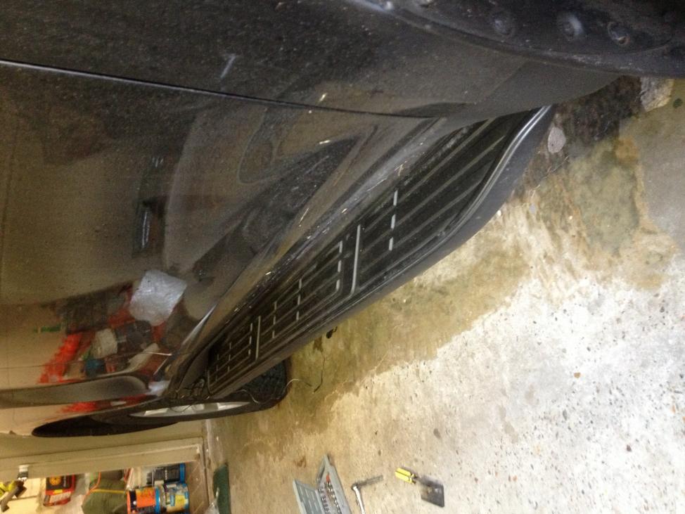

    In the end I found a genuine set of a GXL on gumtree for $150. They were an easy install - 30 mins / 1 person.
    If anyone else is considering it :
    The mounting bolts are already present on the GX.
    You will need to remove the very small front mud guard (see pic) for them to fit. A similar sized guard comes as part of the steps.
    They only fit one way, so you can't stuff it up.
    Cheers.
