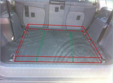

    I’ve been thinking about this issue for a while now and have come up with a plan but need some help...
    Here is my proposal; A Rear Cargo Area Water Tank - This eliminates the need for storing water under your car or on the roof rack - which from reading a number of posts on here seems to be a pain either way.... I reckon we could make a water tank - either out of metal or very hard plastic that pits in the cargo area (with baffles to stop the water splashing around whilst 4 wheeling... and it would be strong enough to sit your fridge on! What to you think??
    Things to note.. if you have luggage hooks as i have (from pelican parts) and VERY useful for strapping down fridges/gear etc - they could be still be used to do that job as well has hold this theoretical water tank in place and your gear with a bit of extra rope.. Also very easily removable when you want to use the back seats!
    What i need is someone in Melbourne (obviously recommended by pradopoint members who is 1 willing to give it crack/make it, water tank specialist? and 2 if enough people are interested in my little concoction... maybe order a few of these at the same time to make the said tester happy?
    Thoughts are welcome!!

    There is one major negative about flat water tanks and that is if your vehicle is not parked on level ground, a large percentage of the water can move away from the water outlet - rendering the tank near useless. You also end up with very weak water flow (iif it is gravity fed).
    My suggestion would be to slide the middle seats to their forward position and build a tank in the gap behind the seats.
