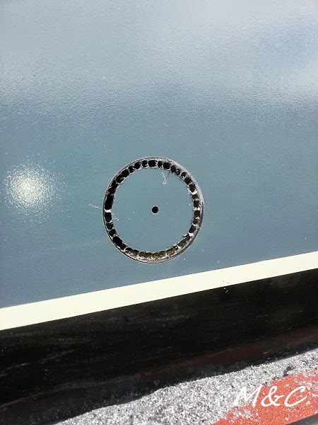

          Hi seymour it really depends how handy on the tools you are. They are not that hard to install but the potential to stuff something is also there. If you take your time and measure everything very carefully (10 times ) you shouldn't have any problems. There are several ways to make the large hole required, as you mentioned you can use a large hole saw, or you can stitch drill with a smaller drill and trim. Either way you should apply masking tape to the painted area so that it protects it minimising any chance of scratches.
          Stich drilling is a great way to cut large or irregular shapes into materials, very easy to do just takes a little longer. Basically mark the shape you want to cut on the masking tape, just inside this line using a smaller drill bit (4-6mm is good) drill holes as close together as possible around the circumference. Then use some tinsnips or side cutters to gently snip any metal left between the holes. when this is done the centre will just fall out, with a sharp file gently file the hole out to your line, remove the tape and paint the exposed metal. If the hole is a little rough it will be covered by the body of the snorkel anyway.
          The picture below shows it more clearly.
              [ATTACH=CONFIG]17156[/ATTACH]
              Thats some good advice on stitch drilling Kev - BUT there is nothing like the sound of a huge hole-saw munching it way through a fender panel!
