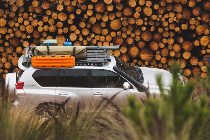

                        Please, if you have any more questions I'd be happy to help you guys out. I'll leave you with one of our tricked out 150s with the Backbone.
