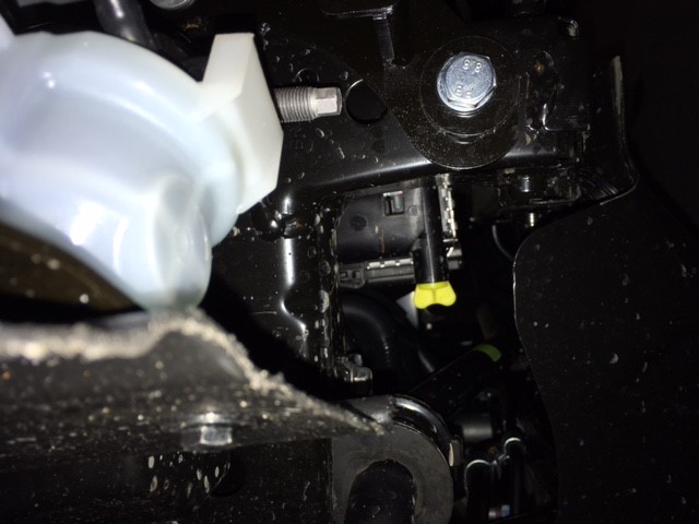

    If you take a photo from the wheel well of the bullbar brackets, I can tell you if my recovery points will fit.
      Hi Amts, see attached..Many thanks for your help... cheers Huzze

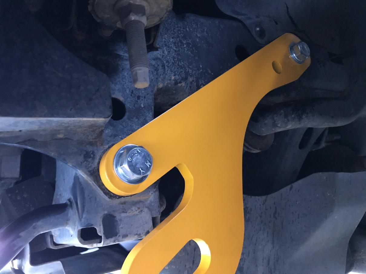

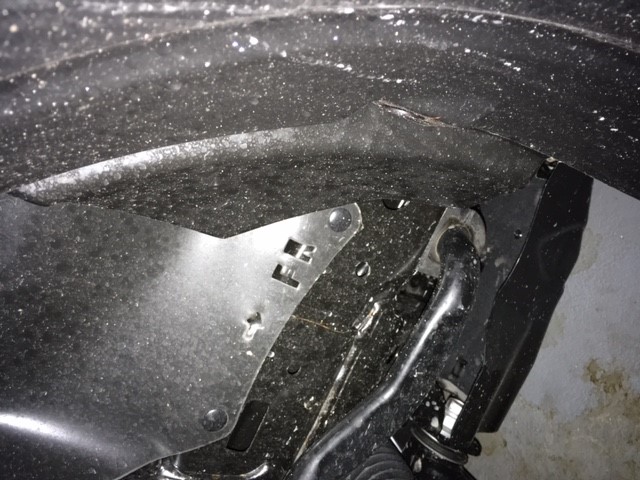

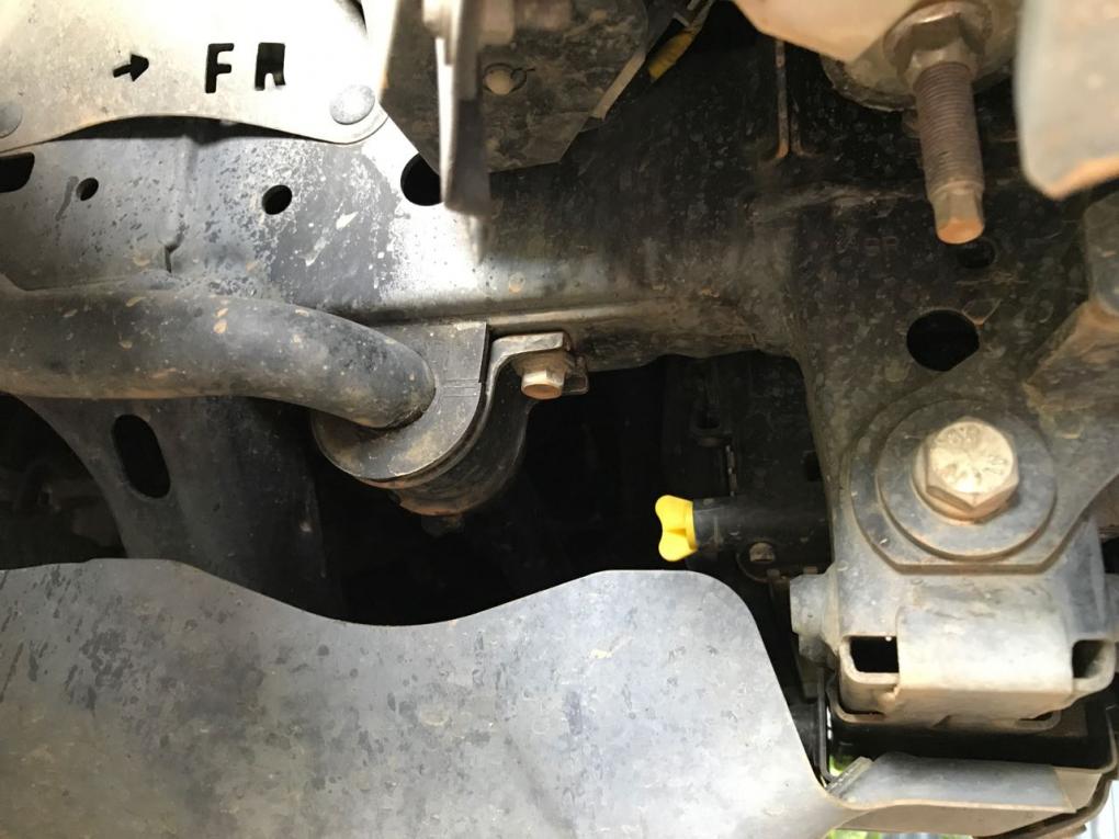

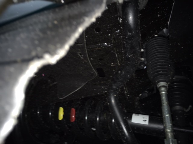

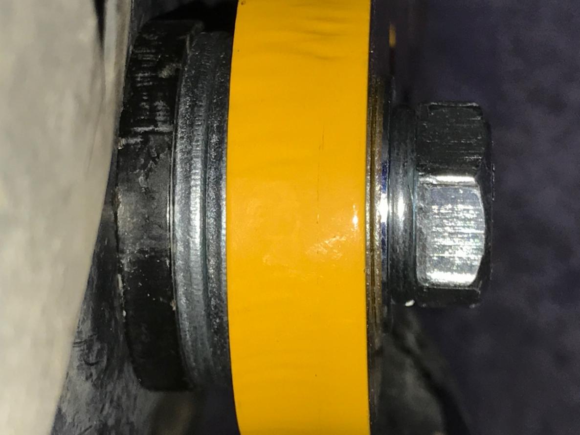

                            Hi Huzza,

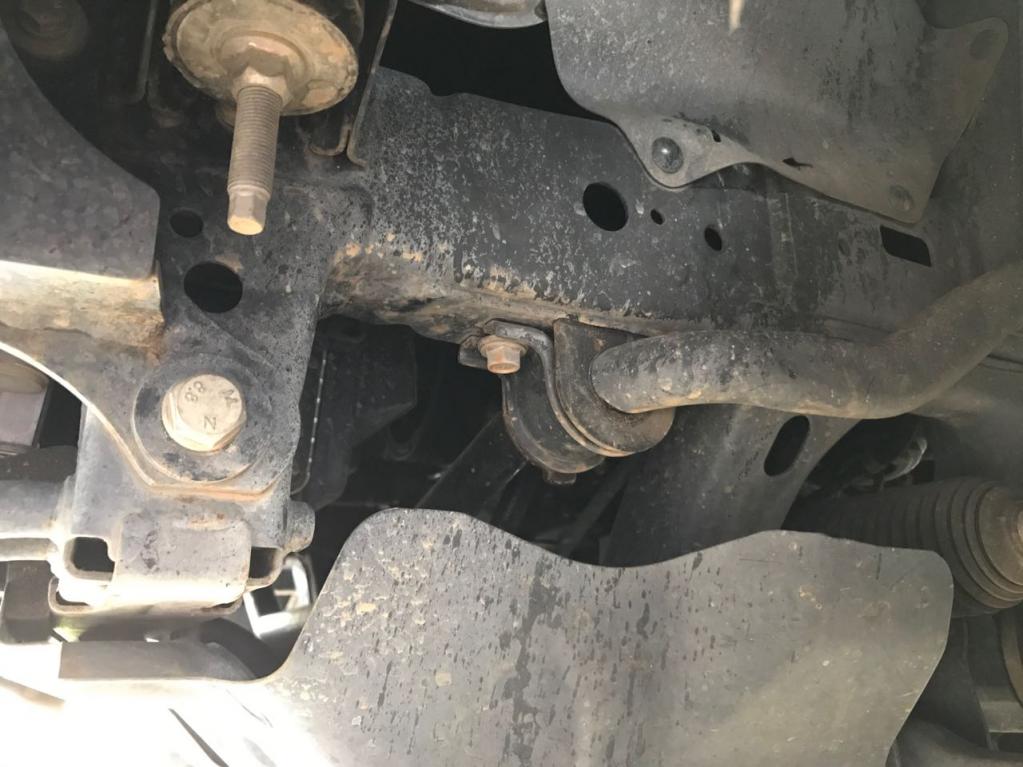

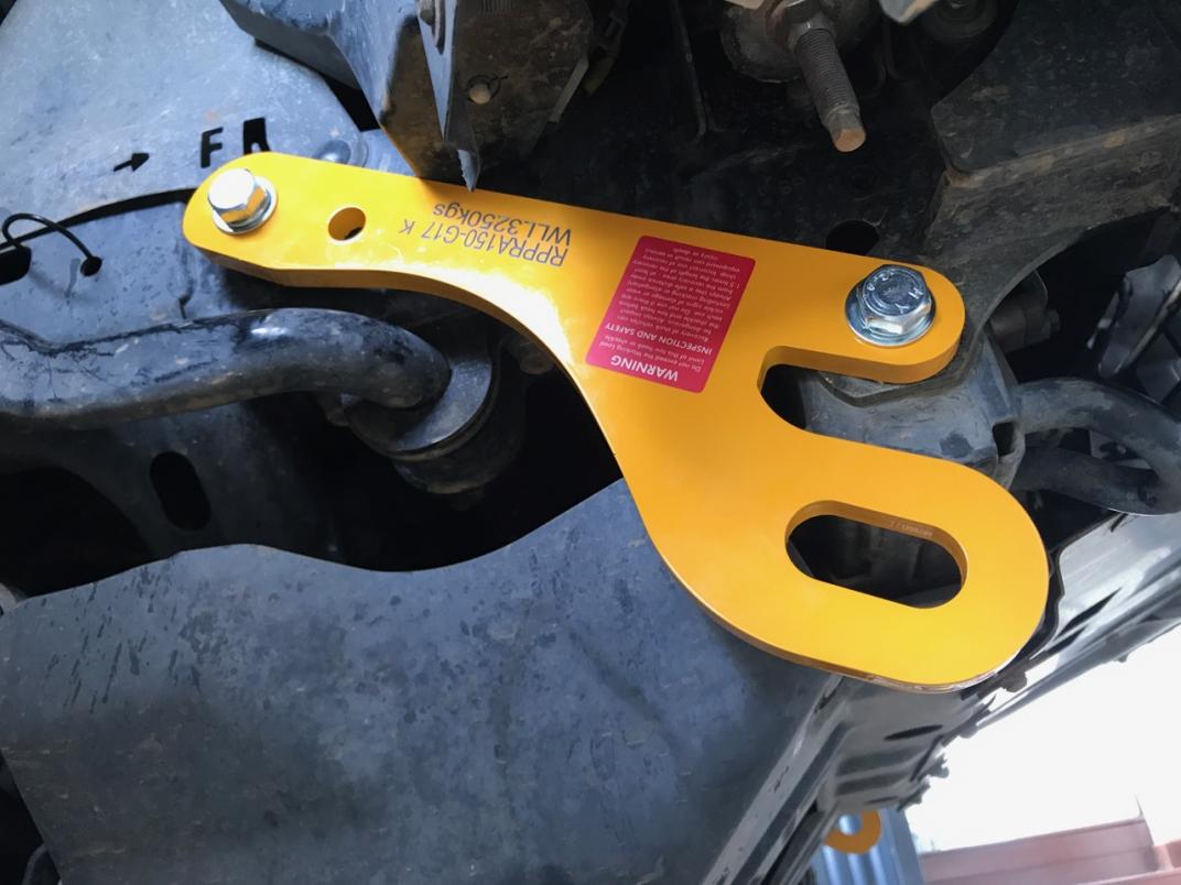

                            Some photos for ya. I've only used 2 bolts per side (minimum required as per instructions), as the middle bolt hole doesn't line up with anything easily. You can see the wires attached to the nut plates protruding from the large square hole a little way back on the chassis. I left them on (bent out of the way) in case I need to retrieve the plates in future.
                            1. Passenger side before (Click image for larger version
Name:	Left before.jpg
                            2. Passenger side after (Click image for larger version
Name:	Left after.jpg
                            3. Drivers side before (Click image for larger version
Name:	Right before.jpg
                            4. Drivers side after (Click image for larger version
Name:	Right after.jpg
                            5. Closeup of spacers on rear bolt (Click image for larger version
Name:	Rear spacers.jpg
                            As mentioned in my previous post, to space the recovery point off the rear chassis attachment (to make it sit nice and flush against the front attachment) I used the large black washer from the front bolt as well as two 3mm thick M12 washers between the chassis and the RP as shown in photo 6. The washers on the OUTSIDE of the RPs (ie under the bolt heads) are the split and flat washers that came with the kit.
                            Hope this helps!
