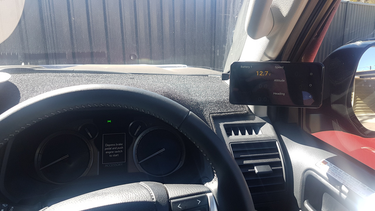

    Mounting:
    The Linx in the Prado sits high. I suppose i could get used to it but and it is not in my vision at all (sits with A pillar behind it) but with the new VDU laws in the NT and QLD I am possibly playing with matches...
    ARB was unable to find anywhere under my dash to fit the unit resulting in in being mounted on my drawers between the drawers and the 2nd row seats. Personally I like the location but in reality I will no longer be able to re-install my 3rd row without major re-wire of the system.
    https://i.postimg.cc/mrWCnm1g/20190704-115438.jpg
