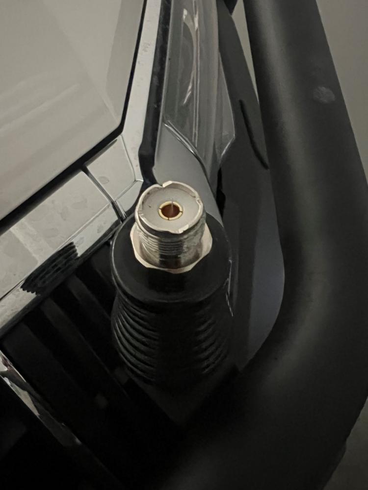

    I have a GME UHF, with a AE4707B aerial , I tend to remove it when in the city, as people steal them, but if I remove the aerial, the connector bit it exposed, I have looked, but can someone suggest a screw in cap, that is the same thread as the aerial, but that covers the spring loaded base connector, so rain, etc doesn't get in.

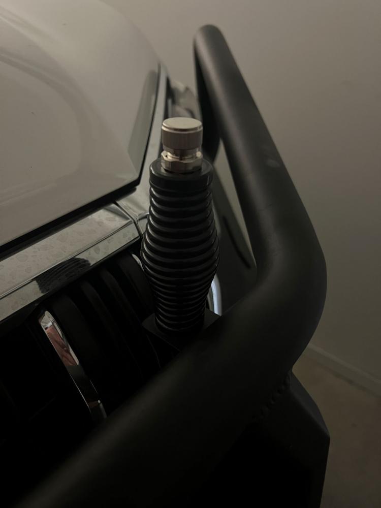

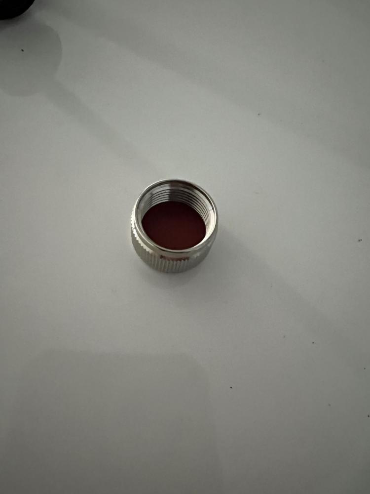

            To close out this post, this is what I ended up purchasing, a N male dust cap for a S0239 connector, cost $6 or so, from my local electrical shop. Just screws over the aerial connector when the aerial is off, and keeps dust and water out.

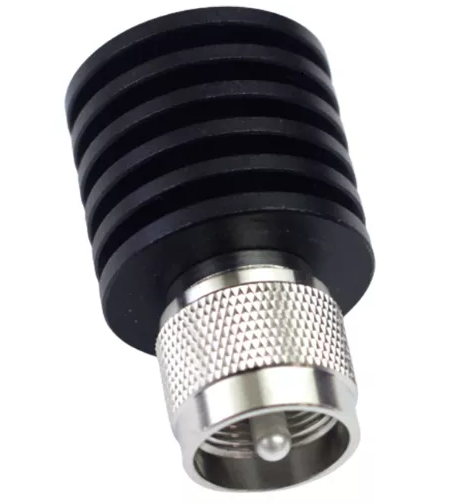

              I fitted a dummy load connector when I removed the antenna. That way if transmit button is pressed without antenna fitted then no damage to output ccts on transceiver. Also stops water or dust.
