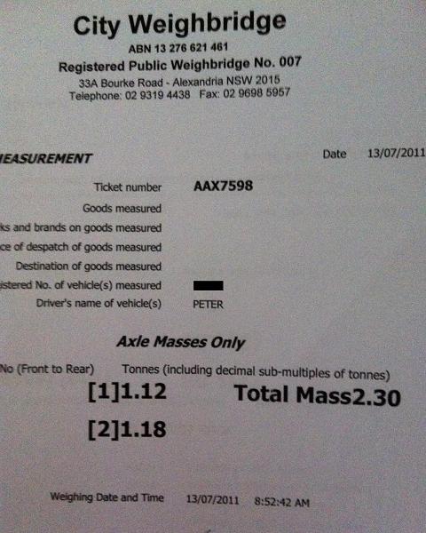

    Gday Peterpilot
    As you know you only have 170kg for bar, second battery, winch & winch cable....... You also have to add on top of that the distributed weight of your passengers/ food Cargo etc/ Back draws, Fridge, Roof rack or tent with its contents and toe-ball weight on top of that which gives you total GVM!! (Gross Vehicle Mass).
    If you add it all up you are left with a heavily stressed chassis and the 150 series has a much less total pay-load due to the much heavier safety cell. (Body).

    Thanks Skywalkerrun,
    If the 120 front axle limit is just 1290kg and my stock weight was 1120kg; then that only leaves 170kg for bar, second battery, winch & winch cable. There would be thousands of Prados that exceed this limit. What sort of front axle weights are the 150 series guys running at?

    Sorry, a bit OT, but where are these load ratings for the 120 published? My 120 was already 1120kg at the front axle when stock:
Name:	Weighbridge Prado.jpg
