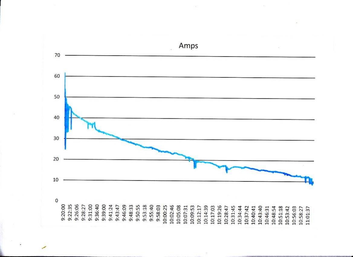

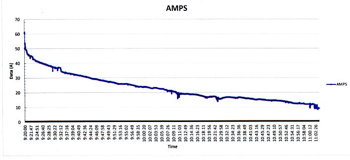

          As above a standard isolator when used in conjunction with a VSR for high compensation alternators will charge very effectively, if you have a older type alternator then you won't need the booster.
          Basic facts:
          A conventional VSR and booster diode if required will replace the bulk of charge into a battery much quicker than a 20A charger can, the following is the results of testing I did with a Prado D4D 120 fitted with a marine pro 600:
          Test environment:
          Toyota 120 Prado D4D
          Cranking battery Optima D27F (fully charged)
          Aux Marine Pro 600 about 50% SOC (12.04V)
          Rotronics isolator in simple VSR mode
          Alternator output voltage about 14.3V – 14.1V
          Ambient temperature 24C
          Monitoring equipment, wireless amp & volt meters.
          Sample Rate Amps & Volts = 2 Seconds interval, range auto.
          The following graphs are constructed from the real time data:
          Analyses of data:
          Average charge rate for first 60 minutes = 28.23A
          Average charge rate for last 40 minutes = 15.1A
          Total charge replaced in 1 hour 40 minutes = 43.33A (86.66%)
          A 20A DCDC charger would have replaced = 33.33A (66.66%)
          Results show a marine pro 600 when discharged to an SOC of 50% will recharge to around the 90% point in around 1 hour and 40 minutes, a DCDC charger would have achieved about 70% in the same time in an in car setup.
          The more battery capacity you have, the more the battery is discharged or the higher charge rates the battery can accept the more the advantage swings towards the simple VSR.
          Also worth noting in the above vehicle the use of 6B&S cable would improve the charging performance, 6B&S though was not used in this case, lighter cable was used to control the maximum recharge current as multiple batteries will be installed.
          To obtain better charging performance using a DCDC charger a 40A charger would be required, however in the above case use of 6B&S would provide similar performance.
          If using a 40A charger the following points would need to be considered:
          A 40A charger is very expensive compared to a simple VSR setup and can only do one battery, if you add another battery the performance will drop to that of a 20A charger, with a VSR assuming a separate feed supply cable is run to each battery from the isolator the recharge time will remain the same for one two or three batteries assuming the alternator has enough reserve capacity to charge them and the isolator is located close to the charge source ie cranking battery.
          You could use two 40A chargers to better recharge times for two batteries but then what you need to consider apart from the cost is that the chargers will continue to draw around 90A from the alternator until the batteries reach the 80% SOC mark or there abouts and the alternator most likely not going to be very happy about that!
          By using a simple isolator and selecting suitable cable recharge currents can somewhat managed to protect alternator, as can they by use of a smaller ie 20A charger if required.
          Leigh
          LeighW

              Leigh can you clarify something for me please? I can't agree with your numbers, 28.23 A for one hour will put 28.23 AH into the battery, more or less. 15.1 A for 40 minutes will put 10.07 AH into the battery so the total would be 38.3 AH. Still more that the 20 A being supplied by the DC charger which could put 33.3 AH into the battery. My DC DC charger rarely puts out its maximum charge rate of 25 A but then the maximum charge rate for my a Ritar is about 30 A and continuous input at this level isn't recommended.
              The speed of charging will depending on a few things, how much the battery can accept (without affecting its life), what the alternator has available as spare capacity and the system limitations.
              mjrandom
              Out of control poster!

                  Hi mjrandom,
                  Yes you are correct, the charge rate is dependent on the SOC of the battery and the battery itself, the alternator voltage, the reserve capacity of the alternator etc, and that is why I specified the exact test environment, ie Prado D4D, marine pro discharged to 50% SOC, the ambient temperature etc.
                  For the 20A charger figures I have assumed the charger will maintain 20A output over the measuring period as the battery terminal voltage was below 14.4V volts the trigger point at which the CTEK reverts to constant voltage charging and below the trigger point for the Redarc chargers, the chargers may well not maintain this level but I have given them the benefit of the doubt and gone with the manufactures specifications.
                  I have added the real time data recording to my post above.
                  Leigh
                  LeighW
