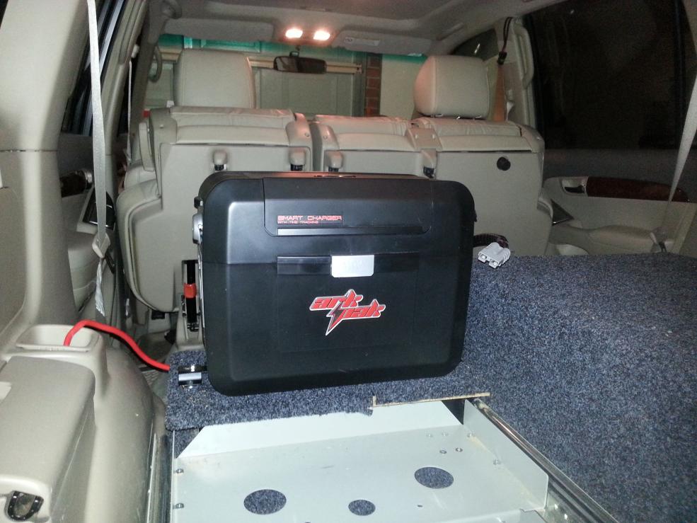

    I have put an arkpak in the rear of my car to run the fridge and anything else i need
    http://www.arkcorp.com.au/p/3231/ark...0v-battery-box

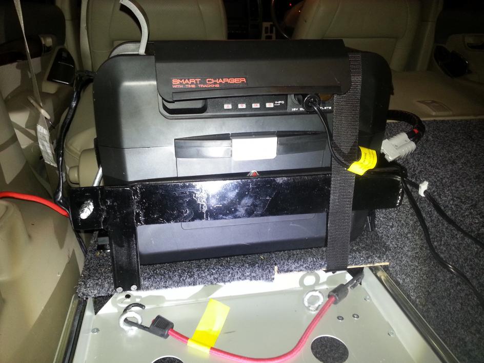

              Its a pain in the butt to mount anywhere in the car safe.They sell a mounting kit for $20 but its ok for an empty box, as soon as you put a battery in it the first bumpy hill you come across will rip it off its mount. ( see photo of mount ) its just 2 3mm x 20mm slides that go in about 10mm
              so i had to make a holder for it with a swing away bracket at the back so i could remove it
                This is my bracket
                  Good set up Graz, I havnt worked out how/where I'm going to do mine yet. Might have to either modify my draw set up or maybe go on top. Waiting to mount cargo barrier so I can set it out. Just waiting on some brackets getting made up for barrier......Cheers steve
