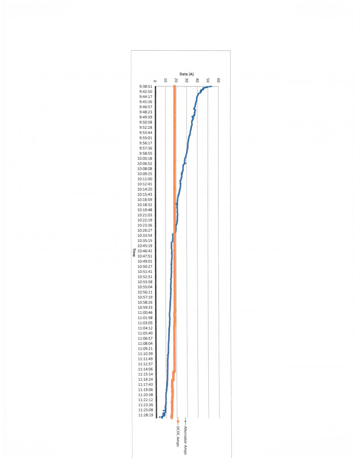

Thanks for that graph Leigh.
For many years now, I have been asking why, if these wonder devices are so good, that none of the sellers of these wonder devices supply graphs to show how these wonder devices work when compared to how an alternator charges.
NOW EVERYONE CAN SEE WHY THEY DON’T SUPPLY COMPARISON GRAPHS.
As that graph clearly shows, an alternator will do a much better job.

Thanks for the graph LeighW....and l'm trying to understand exactly what it means.
so...This is what I think, but please correct me or explain further.
you have a Marine pro deep cycle battery at 50% state of charge.
the top line in the graph is the charging current being supplied to the battery which for about the first hour, the alternator charging current drops from just over 50 amps down to about 20 amps.
the lower line is the charge current from a dc dc charger, (not connected at the same time as the alternator) I'm guessing it's connected to the same marine pro deep cycle battery at 50% state of charge.
the dcdc charger puts out 20 amps constant over the first hour. I'm guessing the dcdc charger simply can't put out the same current as an alternator.
hence, over the first hour, provided the alternator is connected to the marine pro battery with sufficient capacity cable, it will put a lot more charge into the battery compared to the dcdc charger.
what I'm not sure about then, is what effect the charge voltage has....ie if the alternator is controlled by the ECU or whatever, then the alternator voltage is restricted, but the dcdc charger can charge at a higher voltage than the alternator in the new prado...so....whilst the alternator can charge at much higher currents in the initial phase, surely the dcdc charger charges with a higher voltage? But does that make any difference?
i'm not arguing, or trying to contradict anyone, please don't think that, I am just trying to add to the banter and increase my knowledge....because I also am on the verge of installing an auxiliary battery in a new 2.8 GD prado...and I just want something that is easy, dimple, works, and suits my particular setup.
i am leaning towards avoiding having an aux battery under the bonnet..I have seen and experienced guard cracking from an aux battery under the bonnet...so that leaves me with an aux battery in the rear (which will be set up permanently for touring), ..and if that's the case I am thinking of a dcdc charger...because I can do a longer run of suitable capacity red and black cable, to a dcdc charger...but I would like to have a dcdc charger that also has a solar input option as well for my panels.....but I'm still thinking, still reading, still asking questions....and still very interested in this thread....thanks for the info...and I look forward to more explanation, discussion and options...Last edited by brogers; 04-02-2016, 01:38 PM.SE Qld: GX 150GD Auto, (Feb'16 build): TJM T15 steel b bar, 9,500lb TORQ winch, TJM s steps, Rhino Pioneer Platform (42102B 1928X1236mm), front recovery points, Wynnum towbar, P3 brake controller, TNN Underbody guards, UHF, TREKtable & LED striplight, Custom Fridge & Drawers, Waeco CFX50, 9inch illuminator 160W LED spots, 40mm lifted Dobinson Suspension (Zordo's), ScanguageII, 30 Sec Wing Awning
The top graph shows the Marine Pro being charged via the alternator with booster diode fitted via a VSR and 10mm2 cabling, if 6B&S cabling was installed the charging rate would have been higher.
A DCDC charger does not charge at 14.4V all the time, it has to limit its output current to 20 amps in the case of a 20 amp charger to protect itself from overloading. The charge voltage might be for instance 12.5V at the start of charging and this will rise to a maximum of around 14.4V@24C as the batteries SOC rises. When the battery termianl voltage gets to 14.4V the charger will revert to constant voltage charging.
You can see where the charger reaches 14.4V in the graph where the current starts to drop.
Batteries don't need high charge voltages to accept high charge currents, if the battery is low then high charge votages are not required you can see on the graph where the DCDC charger reached 14.4V and the curretn started falling it is only from around the 70% - 80% SOC point that the higher voltage becomes benifical, charging at 14V or 14.4V will fully charge the battery it will just take longer at the lower voltage.Last edited by LeighW; 04-02-2016, 03:46 PM.HKB Electronics, manufacturer of the Alternator Voltage Booster, Silver 2008 D4D,Lifted,Underbody protection, Alternator Voltage Booster, Tiger Z winch, Lightforce DL, Air Horns, Tanami Drawers, Drop down fridge slide, Outback cargo barriers, Rotronics dual Battery system, Polaris GPS, HF/UHF/VHF, Radio speaker combiner, Long ranger water tank, Diff breathers, Inverter, Snorkel and others
