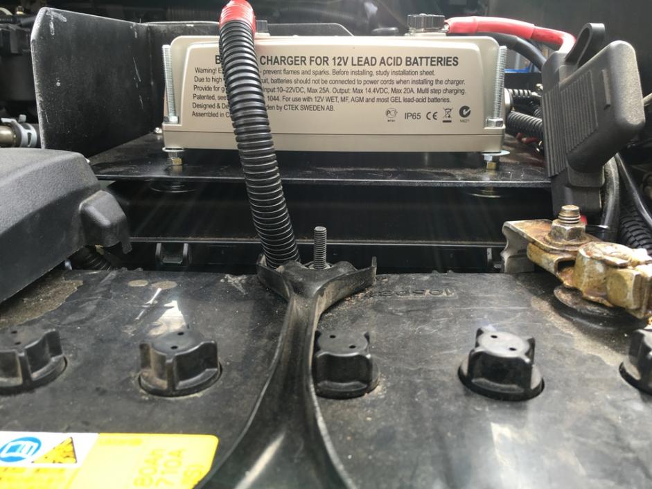

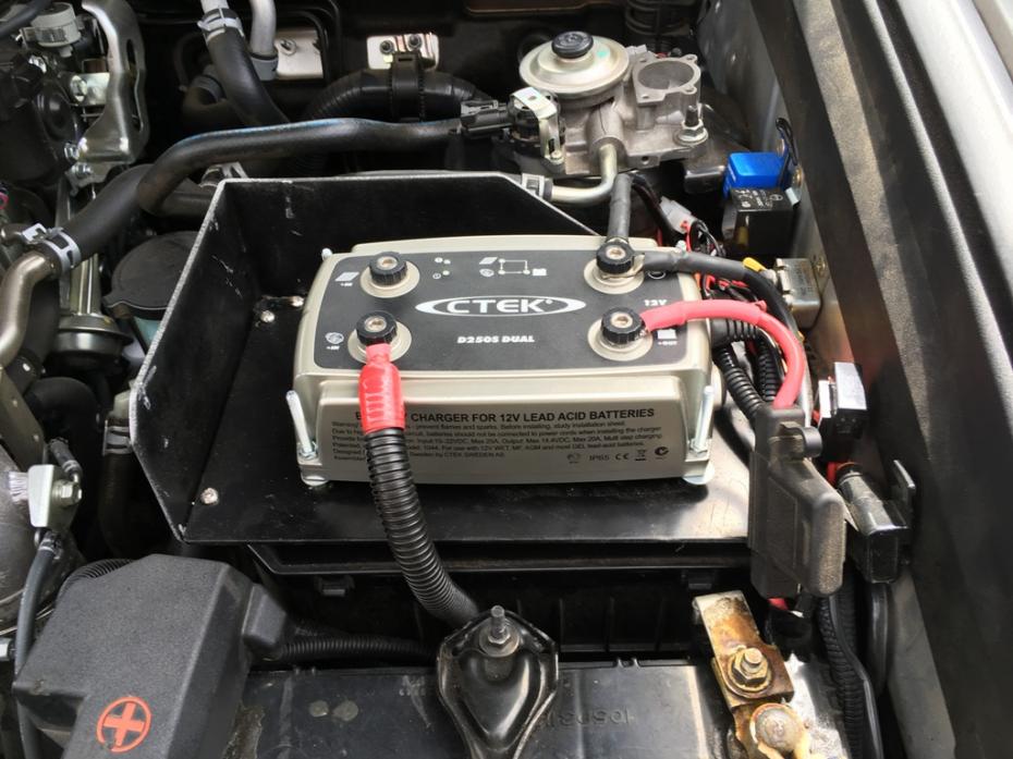

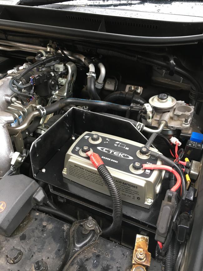

I have a CTEK D250S DC to DC charger. Fitted on top of the fuse box on passenger side behind the battery. It runs hot on hot days so I put a heat shield around it with air gaps under the heatshield and under the charger. Has anyone else had issues with their charger derating in hot weather to a point where it hardly charges.

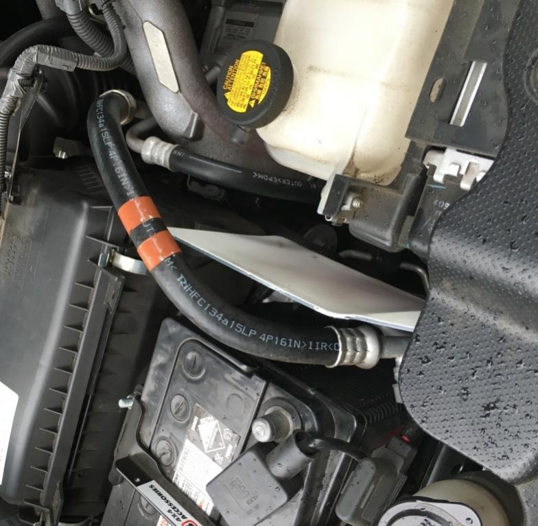

I also put a heat shield beside my second battery to help prevent heat from the engine cooking it. Seems to be working as the plate is hot but battery much cooler.
