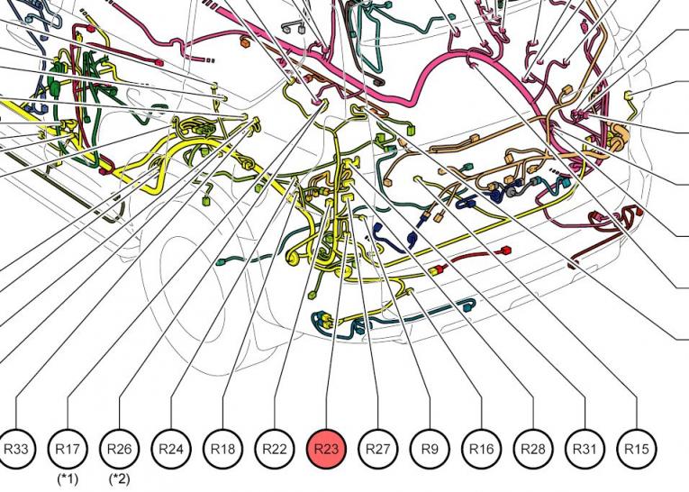

    If the fuse is popping all time now, I'd start by pulling the various wiring loom plugs from rear first. Once I get to my PC I'll post a few pics of the loom and plug locations. The full service manual on DVD is very handy
    As for the annoying door chime. That's an easy fix. You can easily remove the main instrument cluster and screw a small self taping screw into the little piezo buzzer mounted on the back of the cluster. You'd be hard pressed to hear it after that. Takes all of 5-10 minutes to fix.
    Edit. Looks like there is a trailer loom connector somewhere behind the left taillight or probably inside the left rear panel on the inside of the cargo area. I'd start by unplugging that.

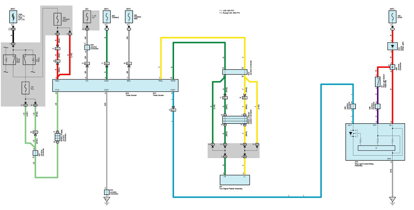

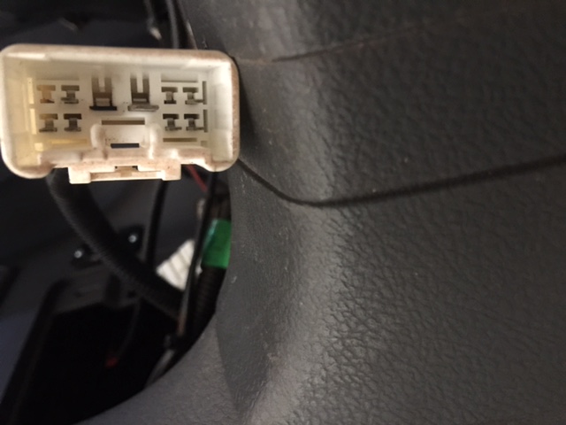

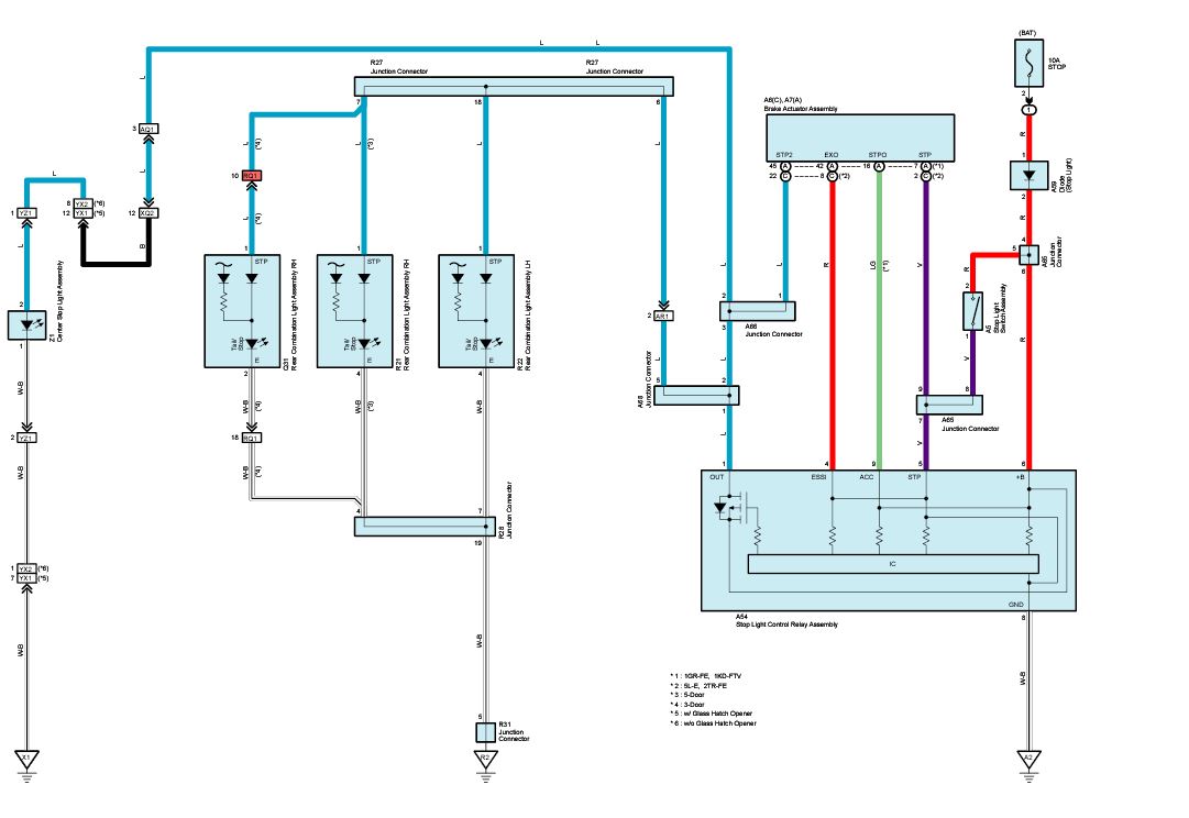

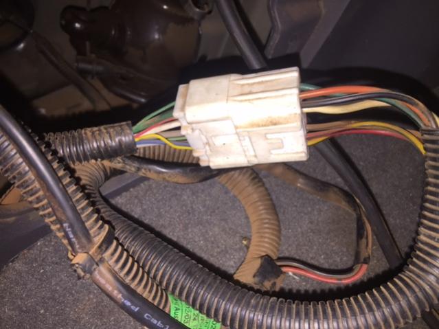

                As I mentioned earlier pull the connector inside the left inside rear panel. This is the trailer plug loom so wont have an affect on other systems and will isolate that part of the wiring loom. I disconnected that plug and all my tail lights are still working.
                In the pics I posted yesterday, the middle pic shows this trailer connector on the left. This not the trailer plug on the towbar but another connection upstream (the one pictured) on the main wiring loom that can be accessed very easily like I said from the inside panel.
                9/10 the trailer wiring and the socket are main culprits with these type of faults so best to eliminate these first as you know.
                I've taken some pics for you of my connector inside my Kakadu. There's plenty of slack in there to pull the loom out of the recess and unplug it. All the colours and the connector type line up with my service manual so this is certainly the correct plug to pull as a start.
                As worst you lose trailer lights. Throw in a new fuse and see how you go over a day or so.
                Edit. Also double check your jack is correctly mounted inside this little recess and hasn't fallen down and damaged the wiring loom inside there.
                  Argh! Yes the jack was (somehow) loose inside that compartment. I have taken out the fuse that powers the trailer loom and controller box. Will see how we go. Thank you for your advice and help.
