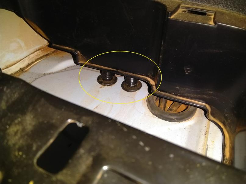

                      I've just recently installed a fridge power point inside the rear cargo space. I ran the cable into the cab from outside through a rubber grommet near the fuel filler. Remove the plastic jack access panel to find this grommet. On mine it has a cable bundle running through it. Push a cable routing tool or piece of "yellow tongue plastic" down through the grommet hole and you should find it emerge near the chassis below. The cable can be squeezed through the rubber grommet, taped and reinstalled in its hole. Once inside the cabin the fun begins...
                        I routed the cables on the driver's side via the existing door-sill cable channels. Behind the back door, the cables go over the (steel) wheel arch but under the plastic trim panel. Cables go through the floor behind the side/rear of this panel. See exit point image. Note that I have removed the third row seats to save weight and create space.
Name:	Anderson Cable Exit Point.jpg

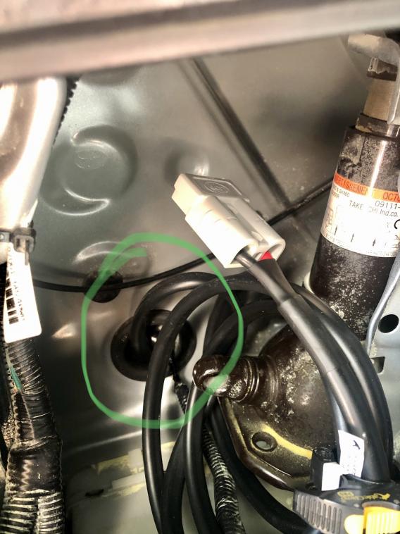

                          Thanks, I wired 8 B&S through that grommet, very easy to find it, just next to the jack, I removed the whole grommet first and pass the cable to see where it goes ... then I put the grommet back and did a small cut, with some silicon in spray helped the cable to go through, you can see it near the chassis as indicated, then I used cable ties and tubing split to finish the installation in the tow bar. The idea with this cable is to feed the camper trailer and also the have an easier point to connect the air compressor or solar panel without the need to open the door. I cut the original terminal from the air compressor and replaced by Anderson Plugs, so I can connect from outside point without the need to open the bonnet.
                          My idea is to use a second battery inside the car using a battery box, so my rear cable will be connected to this box (another Anderson Plugs comes from front to cabin)
