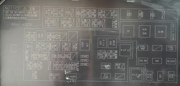

    Can someone please tell me what relays do what in the fuse box. My horn has stopped working and I have checked the fuse, horns but cannot find the correct relay for it. In looking for this I realised that I have no information on what relays do what in the fuse box
    I have labeled all the relays I am interested in, and I know 10 is the radiator fan relay
    If anyone could help I would appreciate it
    Did you look inside the lid?
      Apparently I did not! Aaaarrrrhhhh I hate it when its so simple.
      Reason I didnt was that I have my DC-DC charger mounted on top so difficult to turn upside down. Pity they dont put an outlined drawing in the manual seeing they already have one done.
      Anyway found the issue is in the steering switch asembly, appears a bit of a common fault. It works intermittently so replacement of the horn steering module perhaps.
      Anyway thanks for the advice, got me sorted.
