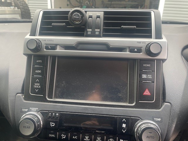

    how does the factory navi gps work? mine is a 2015.
    i know the maps are on the SD chip but how does it know where you are.

    Are you asking if the factory unit has a GPS antenna?
    If the aftermarket unit needs a sim card to work it is using cell towers for location and mapping data as opposed to having the maps loaded and a GPS chip/antenna.
    There will be aftermarket headunits that you can load a map program/app on to and have a integrated or remote GPS antenna. Those that do most likely will not be the cheapest as the better functionality will add cost. For example the Polaris 7" unit from GPSOz.

      is it an antenna in the glass for example or is it in the factory headunit?

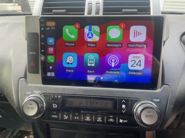

            no joy with the factory antenna doing anything more that the aftermarket one. obviously toyota sd and headunit work to provide gps.
            loving the upgrade and more than happy. i added a wireless charging pad and dash cam too
