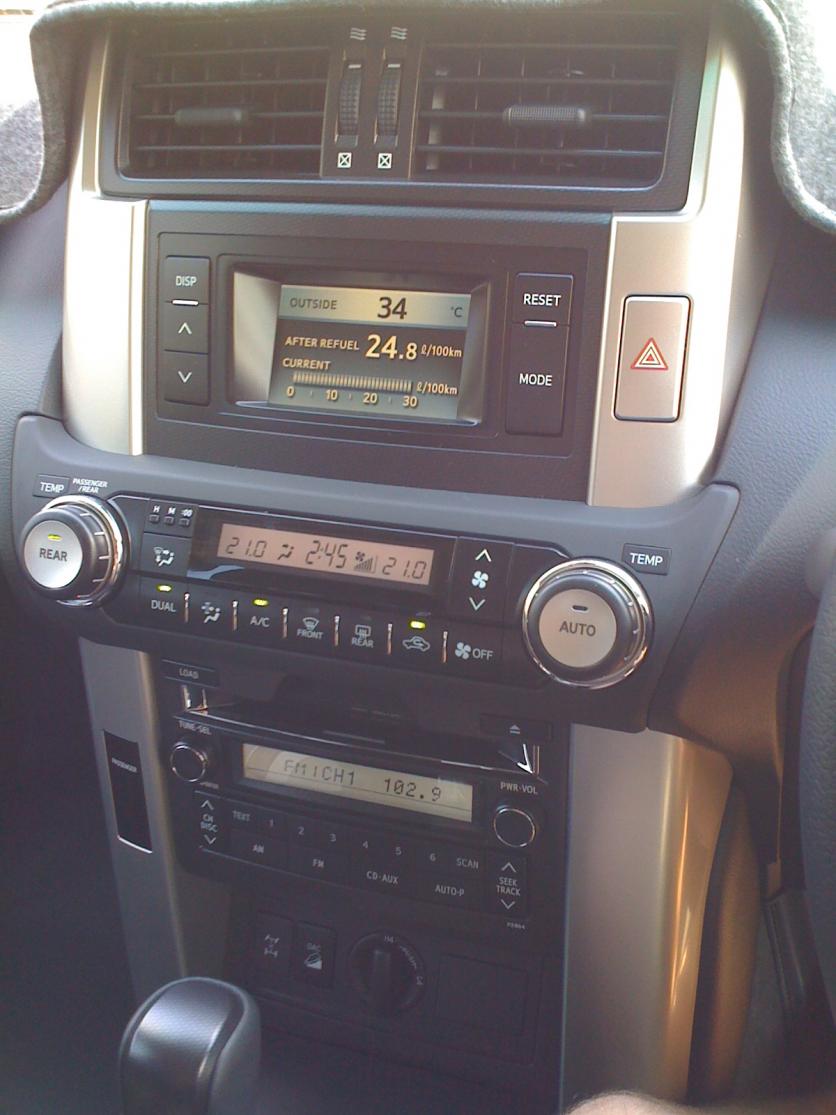

                    • [ATTACH=CONFIG]5021[/ATTACH]
                      extinx unit compared to oem

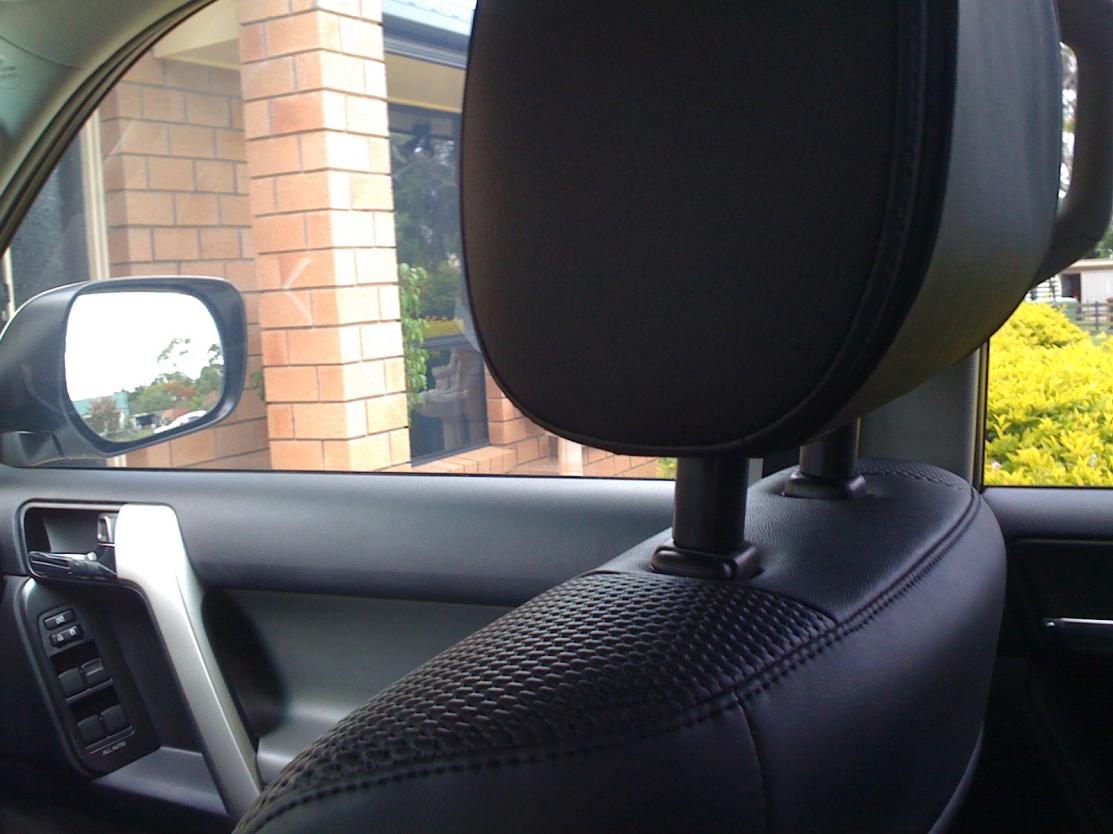

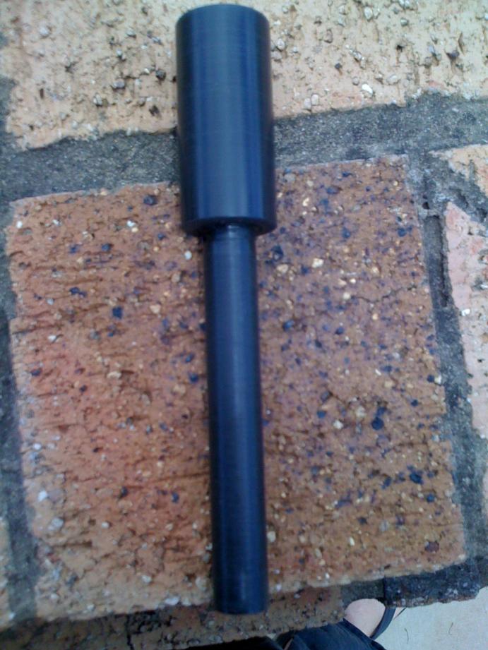

                          Dave,
                          The headrests work well, I wasn't very happy with the mounting so I made up some spacer/adapters to suit the prado seat as the original locks in the seat couldn't take the weight of the new headrests and sat at the lowest adjustment.
                          I am in Clermont so if you need some help I can turn some up on the lathe.

                              • Hi Guys, I am installinging an Extinx GPS/DVD into my GXL and was wondering whether you have to lengthen the cable for the hazard light switch when you installed the screen as the hazard switch goes from the RH side of the small OEM screen to the LH side of the Extinx screen? Regards, Pat
