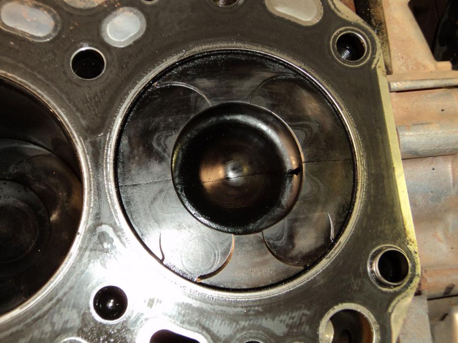

              Hi All,
              Attached (hopefully) is the photo of the number 1 Piston that is cracked in half !!
              I have been told that they are replacing all 4 pistons and number 1 injector.
              Even though its getting fixed it still leaves me with a "48,000km Lemon, what next" taste in my mouth.

                sorry to hear and see what has happenend to your rig, curious to hear what toyota says was the cause of the failure

                  As with all mechanical devices sometimes things go wrong. By the sounds of it your injector has crapped itself, fired directly into the centre of piston and that part of the piston has gotten hot and cracked. A very small problem has gone bad.
                  I wouldnt worry about it being a lemon. If cars didnt break down we wouldnt need warranty would we?
                  You should be fine once its fixed and it could happen to anyone in any car anywhere.
                  Be happy.
                    I must say that is the second one we know of on prado point (see my earler link). Is Roo right, can this be cetane level in fuel and/or bad injector design? I must say that this sort of thing was kind of unheard of in the 100 series landcruiser.
                      I would think possibly "cheap" injector design. With the fuel rail pressures obtained in common rail injection systems, small faults very quickly turn into major failures.
                      Toyota diesels are not highly stressed by any means with relatively low outputs in comparision to other makes of diesel engines.
                      In my opinion, Toyota appear to have made a corporate decision to only do just enough to meet emisions etc, the apparent ongoing issues with injectors would seem to indicate a lack of development ie money spent.

                          Roo, how much smoke should these engines push out under hard acceleration albeit briefly and can such an issue be an early indicator of injector problems occurring?
                          Is this pooling of fuel on the piston directly related to the injector/engine rattle issue?
