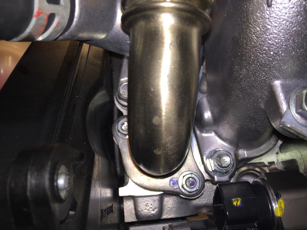

                            Already took your advise and put the blank back in with the 7mm hole as you said better than nothing at this point.
                            I have found it easier to cut the corners off like some on the market. Remove the two nuts from the head and loosen the bolt under the heat exchanger then price away carefully as you bring the plate up from the bottom left looking at the side of the motor. Easy even with my old arthritic fat fingers.
                            2016 ISUZU DMAX TWIN CAB.
                            • I have done exactly the same as you Poppy Joe. Not easy to see what you are doing and rely a lot on feel. Camera on the iphone was good to check it was in place correctly before tightening the nuts up. Found it easy also to pull the sensor plug that was in the way of the lower right hand side nut. Remember to re-attach it. In the picture attached can see the plug removed and a tiny bit of the blanking plate where it sits under the nuts.
                              • Originally posted by stock2014gxl View Post
                                On new clean cars the plug comes off.
                                On offroaders & a few years old they are usually very stuck.
                                Just to let people know its often not easy to remove plug.
