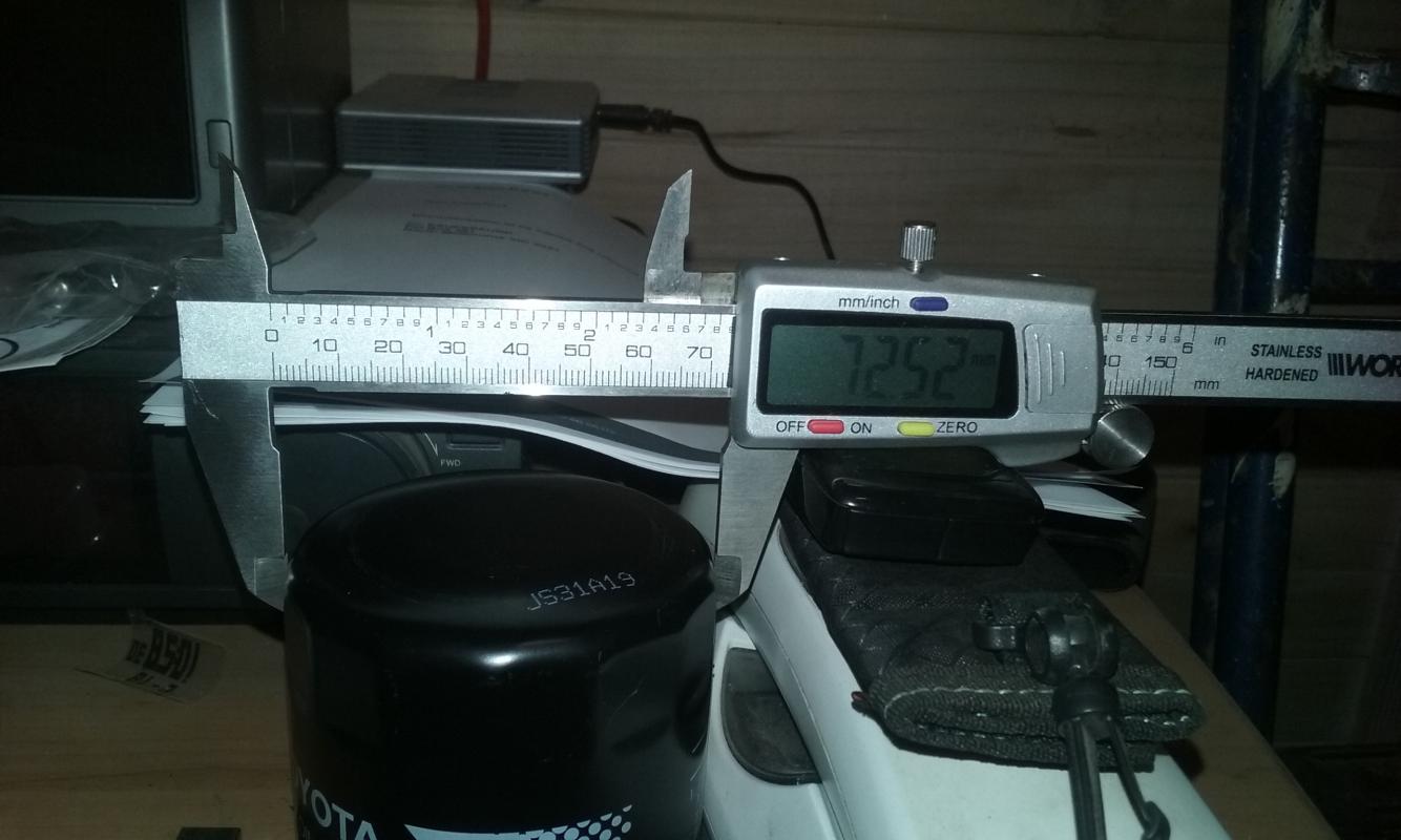

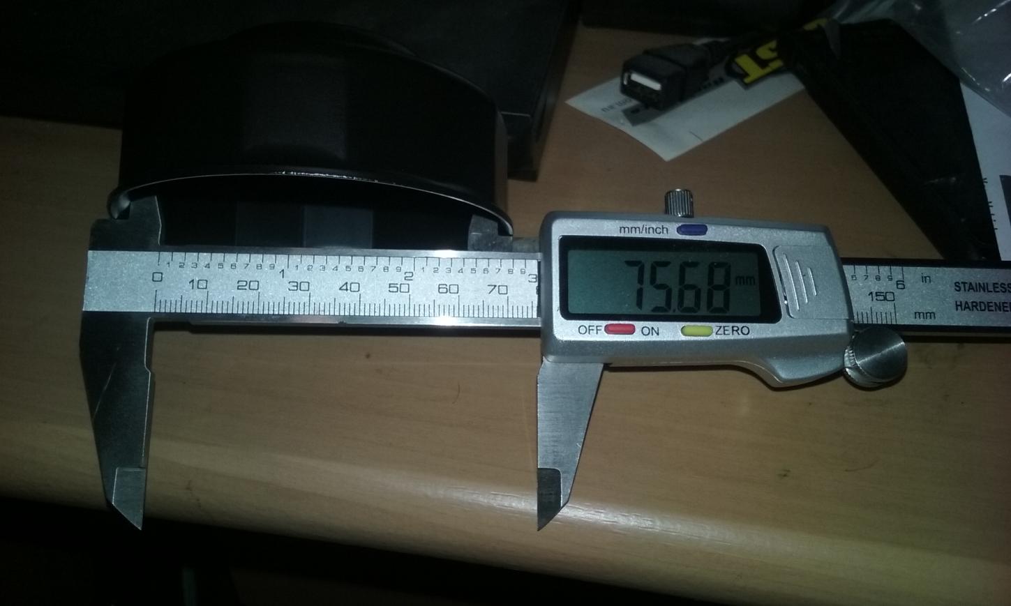

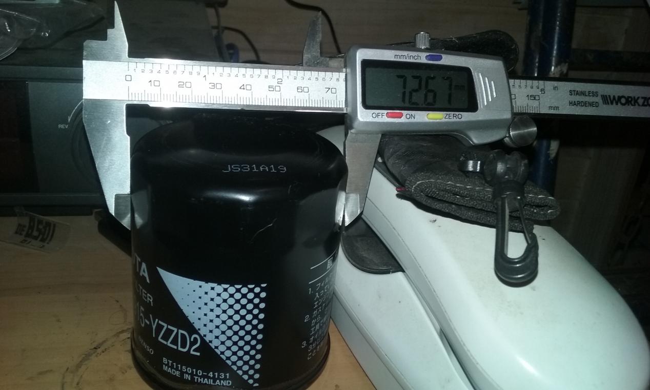

      Is it possible that Toyota have changed the size of the YZZD2 filter. I purchased this from ebay http://www.ebay.com.au/itm/152045604...%3AMEBIDX%3AIT but it does not fit so going through ebay dispute. It is 76mm and the filter I have on the car from new is around 73mm.
      Sydney toyota told me the tool they supply is 75mm so that will not fit either. All confusing as hell.

          Toyota have not changed the size. Are you using the genuine filter?
          Tool part number 0922807501 is marked as 75mm and fits genuine filters marked 90915YZZD2
          My local Toyota dealer keeps this tool in stock, it is the second most popular selling SST (special service tool)

              Yes geniune filter. This is what I sent seller. Not sure why Toyota mark the tool 75mm but the one I purchased was marked 76mm.
