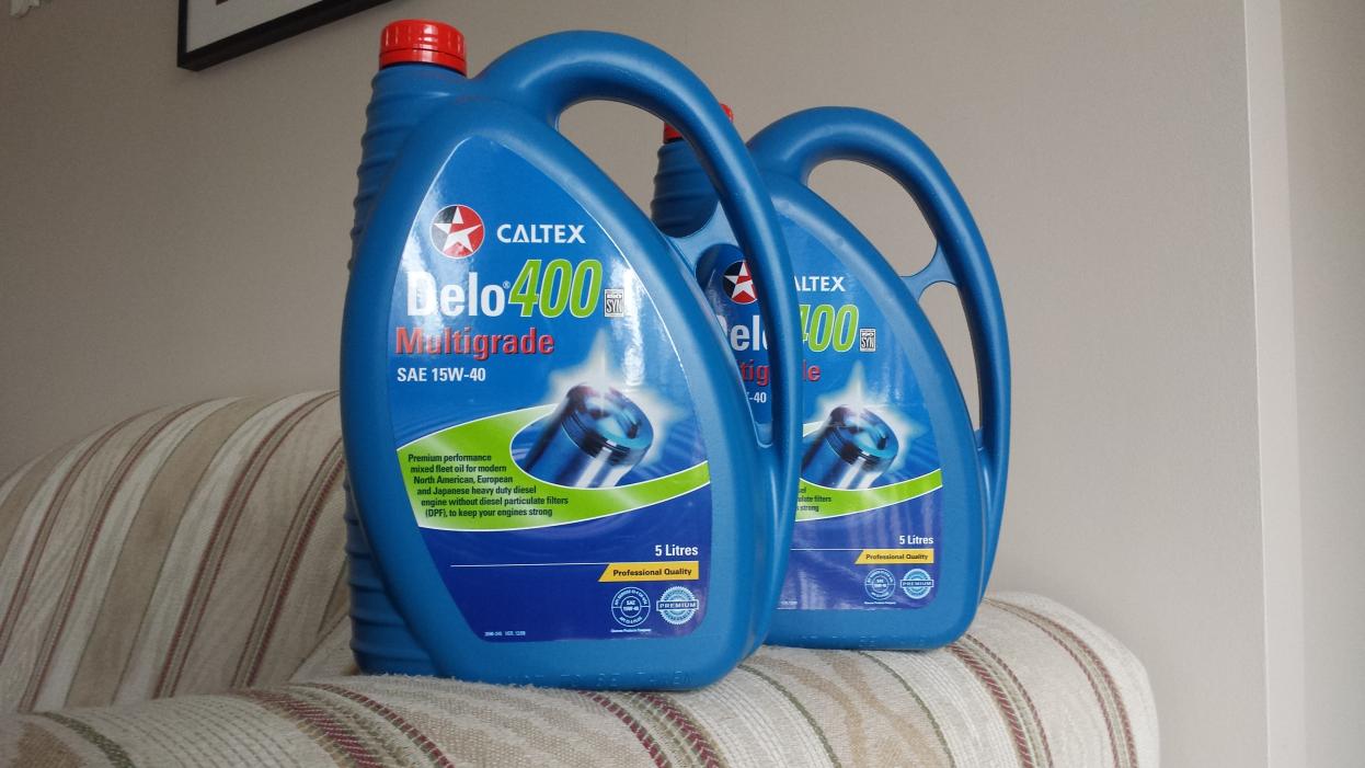

Originally posted by 420blackpony View Posthi mate the caltex oil says suitable for diesel without particulate filter
if you own 150series it has a particulate filter
The oil i linked above does both anyways.[B]2010 GX ,D4D, 6 Speed Manual.[/B] 17x7.5'' +15 FJ Cruiser alloys, 265/70/17 Cooper ST MAXX, ARB bar, Tigerz11 winch, 2'' Dobbinsons lift, Superior front swaybar spacers, extended rear swaybar links, dual batteries, 65L Waeco, custom rear storage, cargo barrier, Fuel Manager pre-filter, breathers, UHF, Narva driving lights.
