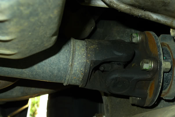

            Toyota Uni Joint (Spider) and Slide Yoke Grease Points
            6 grease nipples altogether
            Toyota owner manual states a lithium base NLGI 2 grease in Spiders (uni joints) and only molybdenum type or Lithium in Slide yoke.
            Starting from the rear axle, 1 nipple

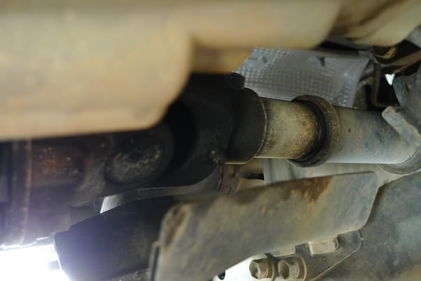

            Foward end of rear driveshaft, 2 nipples

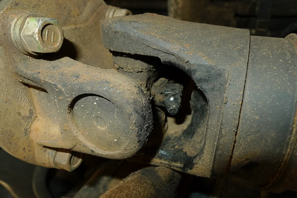

            Foward driveshaft, rear, 2 nipples, access restricted by heat shield. 1 nipple (not shown) located in the centre of the uni joint.

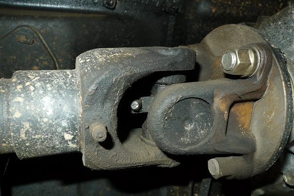

            Foward driveshaft, front, 1 nipple, access restricted by bashplate

            These photos are from an old post and I think off a 120 but we get the general idea, perhaps someone could confirm 6 grease nipples please.
              Yeah that's all 6 of them. You also need to put a blob of grease on the front steering stops. These will be on the front side of the hub towards the bottom. Wipe the old grease off, put a blob of moly grease in the centre of the stop and spread a little.
