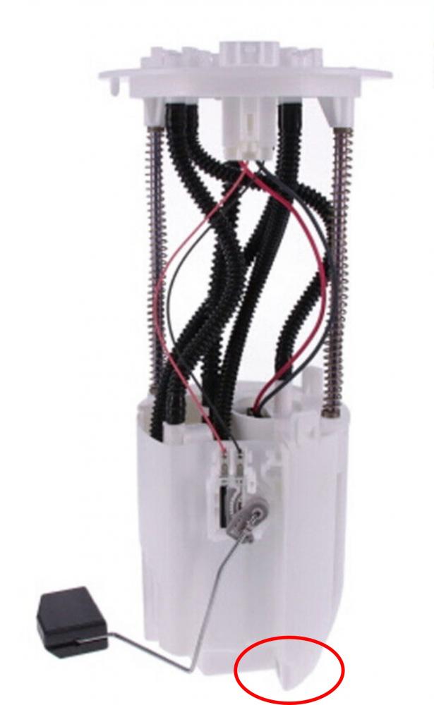

                Well bugger! I thought that I had it solved with all filters replaced AND that little [blocked] breather cleaned and cleared. Today I finally had done enough kms to get the gauge just below the 1/4 mark and the Scangauge showing zero in the rear tank and 35-45 l in the front tank [the reading bounces around a bit]. It stopped! Same fix: added about 10-15 litres, ignition to on position, pump the primer until hard- about 8-10 pumps. It took 2 goes of this but away it went. This clearly means that it is a fuel pickup problem in the main tank when it gets down to about 40 litres left because: all filters brand new, breather clear and clean, no trouble filling the 2 tanks, the venturi is working because all fuel empties from the rear tank to the front main tank quickly at about the current consumption of 11 l/100km. This means it is a tank out job. At 7 years and 84000 km I am not stuffing around trying to find out what is wrong with the pickup and O rings etc. The whole unit will be replaced. Fortunately the part for the 150 diesel is about $650 vs about $1300 for the 120 plus the labour of pulling the tank in and out which I gather is a several hour job. In the meantime I will keep a 20 l jerry in the car until it gets fixed next week. The problem with this fuel issue is that there are about 4 or 5 potential causes you have to work through before you know your specific cause. It would be a simpler problem if Toyota had left a big enough hole in the floor to get the fuel pickup out without dropping the main tank as you could in the 80 series. Dumb. Further report to come when it is fixed and fuel run down to yellow light [which is about 20 litres to go.]

                  Sounds very much like the inlet at the bottom of the plastic shroud around the base of your in-tank transfer pump has become blocked off, so fuel in the pickup area has to come from over the top which would equate to when above approx 1/4 tank remaining mark.

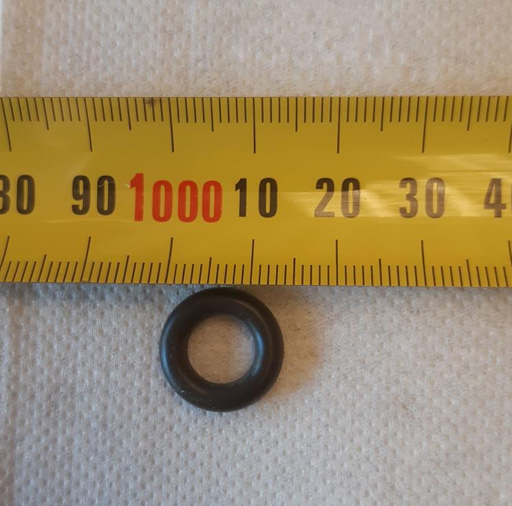

                                Oh. Number 6 : a random O ring.
