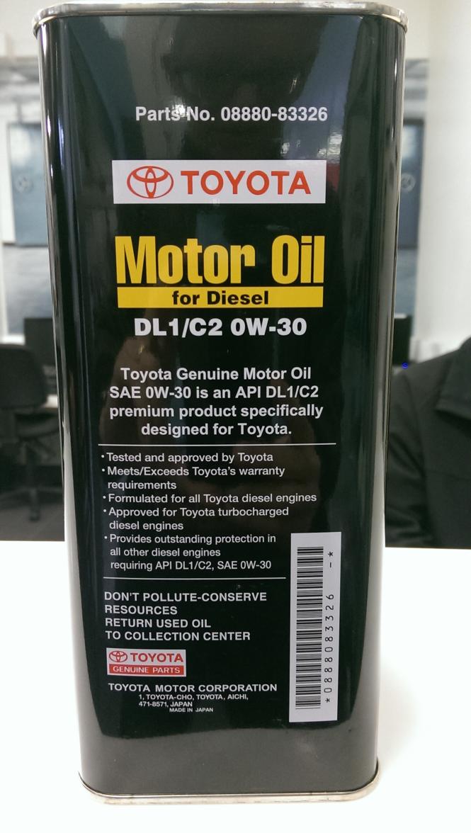

      My dealer showed me a can of the Toyota official oil they will be using on the 2.8 engines. Photo attached. They seemed very clear on which type and why.Click image for larger version

          Originally posted by OzDriver View Post
          My dealer showed me a can of the Toyota official oil they will be using on the 2.8 engines. Photo attached. They seemed very clear on which type and why.[ATTACH=CONFIG]23107[/ATTACH]
          That's the old oil, no longer available and had been superceeded to 08880 83327 and retails for $85.40 a drum for 4L. So the parts bill for a basic oil & filter change add up to almost $200, that's before labour using all genuine parts & fluids!
