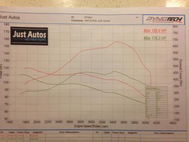

                      Flash tune done Matt from just autos Nambour Sunshine Coast qld
                      Awesome guys and to drive now
                      Dyno is just a tune no other mods
                      Standard exhaust I did have snorkel and slightly larger than standard tyres this was all done when I bought the car 1 1/2 years ago

                        Hey dirkw those figures are a little hard to see what was the before and after figures for torque? How does it perform now is it a big difference and do you think it was worth it?
                        cheers Ryan

                          Looks like. 30% increase, 300 to 400 at the wheels.
                          So approx 533nm peak but not everywhere, the area under the graph is what determines overall increase and I can't work that out on my phone.

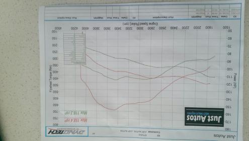

                            Hey guys here's a better pic
                            Don't forget stock exhaust and 265 70 17
                            Also dyno doesn't read properly bellow around 2800rpm
                            This is where the real gains are felt

                                What? 2800rpm? I think that is a typo since the engine hits peak power at that point so what your saying the entire power band is not read properly? I don't think so.
