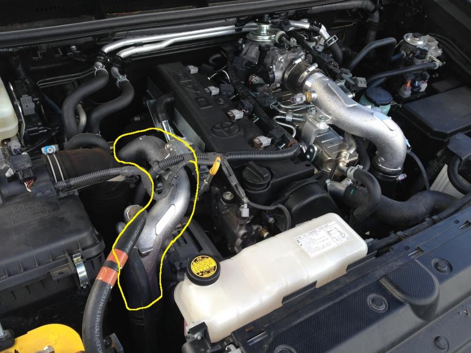

    The issue is, After a day of driving and come to stop I always wait a few minutes then turn the car off, When the car turns off after a few seconds I hear an extremely loud tick/knock, it only happens 2 - 3 times in a period of 10 minutes then goes away. I have attached a picture of where I hear it the loudest

      It will be heat from the turbo cooling down. Mine has done this for several years. The cast iron exhaust manifold expands and contracts when cooling.
      Hasn't caused any issues other than the loud click noise.

        Yeah I went there to show them and boom nothing happened, no sound. This is probably because I live 10 minutes from them and didn't get warm enough. If it gets worse I will bring in.
        @ Rusty62
        Thanks for that, I haven't noticed any other issues just that noise, was getting worried. Cheers for the reply.
