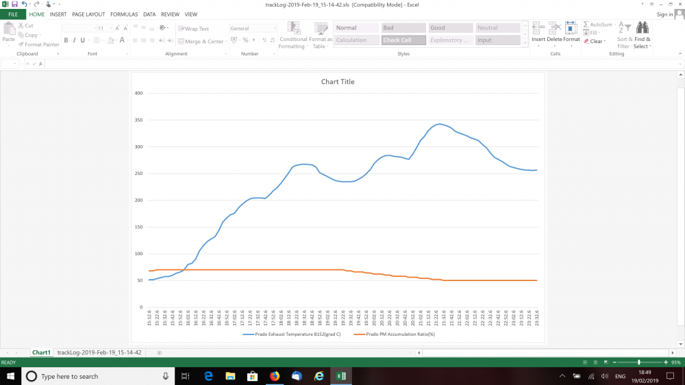

            • I tried logging with torque today and found it does work fine, I found it harder to convert the figures to a graph in Excel but here is a screen shot of a short journey.
              The vertical axis is both DPF temperature and % soot. The horizontal axis is time. I have only included these three parameters for simplicity and to make it easy for me to find out how to do it.
              By coincidence I started off with a cold engine and you can see that the % began to rise then fell back without the DPF temperature ever being hot enough for a "proper" burn. I assume this is yet another instance of the "recalculation"
              Do you have all the pids you need for torque? if not if you send me a PM I can send you all the ones that I have.
              I hope this chart makes sense:

              • Hi John, didn't know Torque was capable to do this much, I've got soot%, exhaust temp in Torque, I will try to put some useful charts here later.
