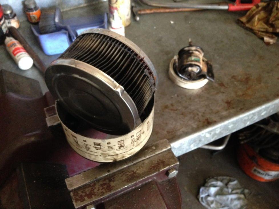

                        below is a pic of the innards of the 2 micron filter element I replaced today at 20,000kms. This extra filter setup is installed after the oem under bonnet unit so has picked up crud that has passed the under body and under bonnet filters and was destined to go through pump and injectors.

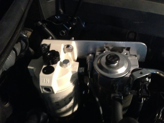

                        • Knocked up a bracket for the racor this afternoon. It's pretty rudimentary but sites it all neatly.
                          Just need to pick up some thread sealant plumb it all up.
                          Question though - having not worked with diesel engines at all before whats the priming process once I've plumbed it? Any tips before I pull the existing hoses off? Talk to me like an imbecile - it's ok.

                          • No just pull the hoses off and reconnect . From memory the top of racor unscrews and you pump it to prime it( should come with instructions). With the factory filter, press the button on top until it becomes to difficult to depress and you should be good to go. Start her up

                            • The black stuff in the filter is not necessarily dirt or gunk. Diesel breaks down and forms ashphaltine which is black. I recon that's what's caused the 2 micron filter you've cut open to be the colour that it is.
